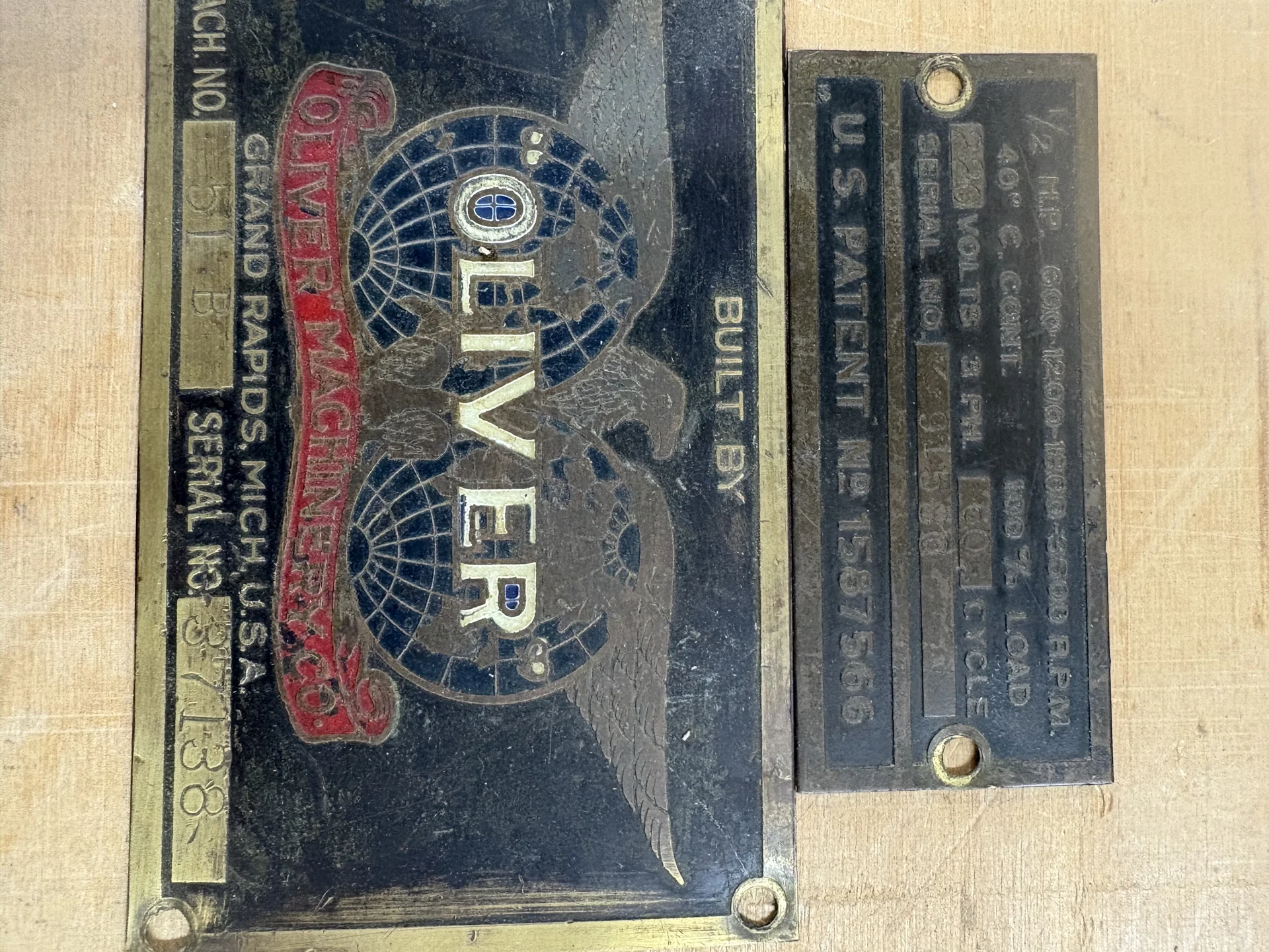

Guineafowl said:
If it’s any help, it looks like your two Dahlanders are:
1. 3600-1800 switching 2 to 4-pole
2. 1200-600 switching 6 to 12-pole.
I’ve also seen someone using a DC power supply to inject controlled current into winding ends, watching the behaviour of a compass needle to check the phasing is correct.
OK, that is almost what I just figured out.
But it is 3, 6, 12, and 24 pole. Being used to thinking about single phase motors, which need an even number of poles, but not for 3-phase.
So, the 12 and 24 pole version will use all pairs of consecutive poles.
And the 3 and 6 use groups of 8 poles. I was trying to figure out before why 16 and 8 are not divisible by 3, (or 6), but it works if you do it that way.
The effect is of 24, 12, 6, or 3 poles, and 600, 1200, 1800, and 3600 RPM.

I have done some additional testing of the motor and observed some things that are puzzling/concerning:
1. When wired in the 600 rpm configuration, the VFD limits the speed to ~300 rpm because the motor is drawing max amperage (2.3amps). This is with no load.
2. When wired in the 1800 rpm configuration, it will run at the full 1800 rpm, but is drawing max amperage with no load.
The motor turns freely when rotated by hand.
I should add that since my motor tag doesn’t specify FLA, I have set that parameter on the VFD to 2.3 amps, the default for a 1/2hp motor.
I talked with tech support at the VFD manufacturer. They had me auto tune the drive and then see what winding resistance the drive detected. It was 8.9 ohms, which matches what I measured via ohmmeter. The drive tech support said that the expected resistance should be around 5.6 ohms.
Resistance across the 600 rpm windings measured 12.0 ohms with my ohmmeter, so that probably explains why the rpms were limited to 1/2 the rated speed in that configuration.
What I would like to understand is whether these higher than expected resistance values are because:
a. those are to be expected for a Dahlander winding configuration.
b. back when these motors were built they “overbuilt” or couldn’t achieve the efficiency of modern motors.
c. there is something faulty or incorrect with this motor’s windings.
In the case of a or b, might it be feasible to run the motor using a higher hp rated VFD? When I mentioned that I had a 2 hp VFD, the tech suggested that I connect it to the motor and monitor the amperage to see what kind of draw occurs with the motor under load. It will be quite some time before I can do this as I have some additional refurbishing to do on tool rest and tailstock before I actually put the lathe into service. And it is likely that before I can get that accomplished I will be traveling for a couple of weeks. But I thought I’d throw this out there in case someone had some helpful advice.
Re: windings, I’d be checking the insulation resistance, if you have access to a megger. Sanity check - does the VFD output voltage match the motor?
It’s normally one VFD per motor, and you technically have four. The Dahlander on my 1950s spindle moulder (wood shaper) acts as two motors, being 3hp in low speed and 4hp in high. There’s also not supposed to be any switchgear between the VFD and motor. That’s why Dahlanders are tricky to run, and somewhat redundant, with VFDs.
- Pick a medium speed configuration, and control the lathe’s speed with the VFD? You can then tune and fettle the VFD’s overload settings. Try bumping the overload setting 10% and trying some turning. There’s nothing wrong with using a bigger VFD than the motor - I’ve been doing this for years with a 1.5 kW unit running a 500W motor.
- I know of someone who uses a VFD with a small idler motor permanently connected, to make a more versatile phase converter which copes with switchgear. I can ask him for details if you like.
One thing I’ve not seen before is the speed/frequency limiting you describe with the 600 rpm configuration. Is there something about this in the manual?

See picture of the plate below. None of those are specified.
I can’t open this.

Guineafowl said:
I can’t open this.
Not sure what happened there. Hopefully it will work this time.

As you say, the motor plate doesn’t tell you much. Is it still limited to 30 Hz speed?
One thing that I did notice is that the voltage on the tag reads 220v. I had been thinking it was 230v, which is what I set that parameter to. I haven’t changed that. Maybe I should?
