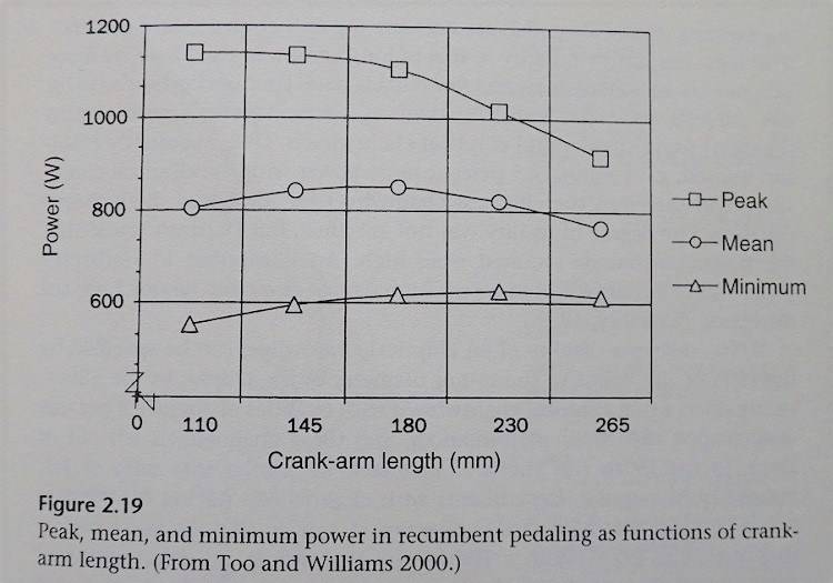

There is a really good book on this subject: Bicycling Science, by David Gordon Wilson. It's in the third edition, and is still available on Amazon. It has 477 pages of bicycling science goodness. Highly recommended. Here is a plot of power vs crank length:
Opinions on crank length have been around since bicycles were invented. This book has the available science on the subject.
I highly recommend reading this book. You will then be able to discuss the subject intelligently. A basic high school physics background will be very helpful.
Yet in the Pro's, there is no clear answer. This graph doesn't say much. Is this for a 1 second all out? Or a 10min effort? Plus while their peak is understandable for a 1 to 5 second All out Sprint. I fail to understand what the minimum represents, because even for a 10 min effort, those minimum numbers are off the charts..
Plus recumbent is not really cycling race cycling... no offence.

That's Dr. Jim Martin's study (https://faculty.utah.edu/u0238089-JIM_MARTIN,_PhD/research/index.hml) 120mm, 145mm, 170mm, 195mm, 220mm crank lengths. 145mm produced most power.

So, I believe you need to look at this from both a mechanical and more importantly, a biomechanical issue?
In general, bike manufacturers are putting on TOO long of crank arms on their bicycles.
Thoughts?
