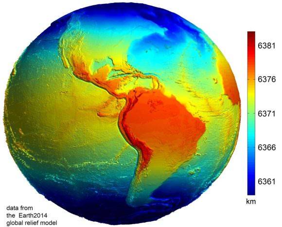

I'm trying to understand how differences in gravity would in practice end up affecting the local height of the sea. We know that at the equator, everything weighs less, and the sea-level is also higher up than average, seeing as the Earth's wider at the equator. But then if you look at a gravity map, you can see that they say that places with stronger gravity will have a sea-level that's higher up. That's in my opinion a contradiction, and I'm having trouble figuring out what I'm missing.
I'll attach the gravity maps made based on sea-level height, then mGal, and then a picture of the Earth's oblate shape caused by Earth's rotation:
The images above are sadly oriented differently, but the blue and red areas correspond with each other, showing that increased gravity = increased sea-level.
Here you can see the diameter of the Earth and how it increases as you get closer to the equator.
I'm hoping that someone can explain to me how this works. If anyone knows of any website or earlier thread that goes over this, then that's good too. I wasn't able to find one.
Notice the scale of these plots. The first one is in meters and over the Pacific Ocean it ranges from about -50 m to about +10 m with little or no prolateness in evidence. The globe is in km and ranges from about 6361 km to about 6373 km over the Pacific Ocean with strong prolateness.
Basically, the first plot has subtracted off the prolateness of the second so that you can see the small little deviations that you cannot see on the larger scale.
