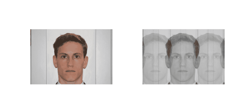

I am coding Sobel Edges detection in C#.
I have a method that converts my image to grayscale.
it adds the R G and B values and divides by 3. and replaces the R G and B value out with that same number. That seems to be working fine.
Then I added a gaussian blur to it by using this :
_kernel = new int [9]{1,2,1,2,4,2,1,2,1};
and doing a convolution to my Image that is in grayscale:
I guess that is working ...

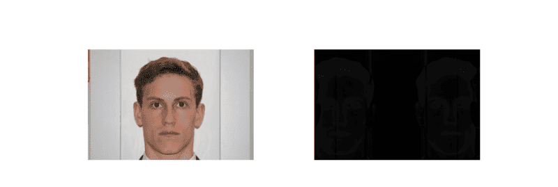

At this point I do two more convolutions. One for the x-axis and one for the y axis. I perform both separately on the same image that now has a grayscale and gaussian blur applied to it.
I do a convolution for X using this :
_kernel = new int[9] { -1, 0, 1, -2, 0, 2, -1, 0, 1 };
with my Image and store that result in a new array called resultX[,]
and then I do another convolution for Y
using this:
_kernel = new int[9] { -1, -2, -1, 0, 0, 0, 1, 2, 1 };
and store that result in another array resultY[,]

but My image is black :
any Idea of what I am doing wrong?

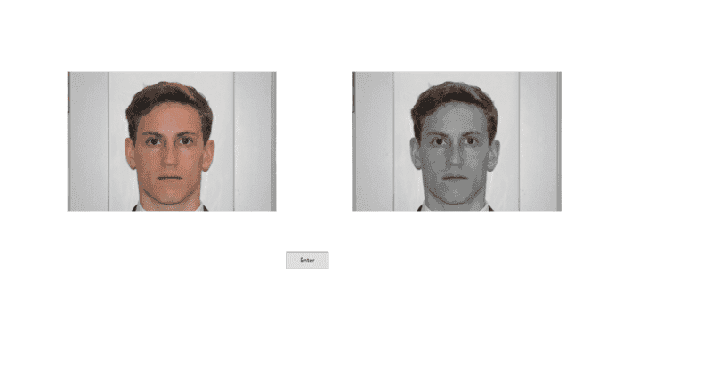

1) yes I sent a picture of the grayscale.

The only thing I can think of is that the values of the gradients are less then you expect. Anti-aliasing in the original image will often put pixels with intermediate values on edges, and the gaussian blur will decrease contrast more. The range of values of a byte is 0-255, if your result values are 0..20, it might all look black.
If that doesn't work, I think there's something wrong with the format of result, or the method you use to display it, but I can't tell it without knowing what graphics/image processing library you are using.

Ok I compared my gaussian blur to adobe illustrator and mines is not working. I did everything the guy said in the video for do Convolution
here is my code:
