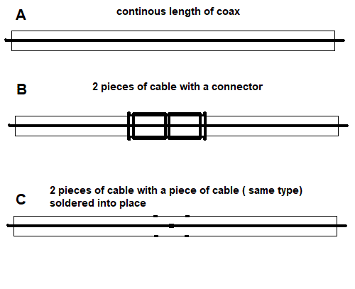

Mzzed said:
. So I was correct in assuming that one connector has positive reactance and the other connector has negative reactance so that when the are connected together, they cancel impedance and are essentially invisible to any signals?
no that isn't correct
As I said (maybe not clearly enough) in my previous post …..
The connectors are manufactured so that they as closely as possible represent the impedance of the coax in which they are to be used.
That's why they are close to invisible in their use when testing the length of cable
look at it this way ……
A … normal length of cable
B … a male and female connector used to join 2 lengths and keep the impedance and losses figures as close as possible
to that of "A"
C … take the 2 separate lengths butt them together and solder/join the centre conductors and the shields at closely as possible
without producing impedance / losses bumps
OR you can look at C as the same as taking a short length of same type of coax and inserting it as accurately as possible between the 2 ends
This is what your connectors are representing/replicating
Dave
