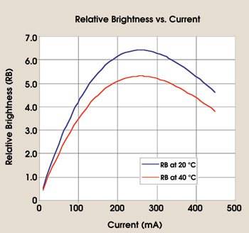

I am getting confused now. From the articles that I read, It says that temperature is a big problem with LEDs.
[source http://www.photonics.com/Article.aspx?AID=29860]
When current is more than 260 mA, the brightness decreases. At 40 °C ambient at maximum brightness, the junction temperature is 146 °C, which exceeds the maximum allowed junction temperature of 120 °C. To prevent exceeding the 120 °C junction temperature, the current for this LED must be kept at 200 mA. At 40 °C ambient and 200 mA drive current, the relative brightness is only five times the 20 °C, 20 mA value. If the junction temperature is not taken into account by increasing the current from 20 to 200 mA, the brightness should increase 10 times.
I know from the fact that most semiconductors, including those ones that diodes are made of, have negative temperature coefficient. This means that the conductivity will go up if the temperature goes up. This effect I saw when I did home made experiment.
Now this conductivity comes from electron-hole pairs being created.
But then again, lattice vibrations go up too with temperature. Is there any limit where things start go down hill? Where lattice vibrations overwhelm the e-h being generated?
Is this what's going on?
