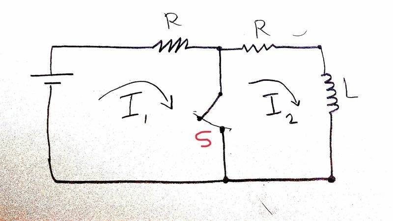

abdullah khaled Messages 6 Reaction score 0 Thread starter Mar 24, 2018 #1 In circuit like this If I closed the switch "s" Are the currents in mesh "I1" and "I2" independent of each other? if yes Why /why not? Thanks. Attachments PicsArt_03-24-09.07.19.jpg 36.4 KB · Views: 841 Last edited: Mar 24, 2018

phinds Science Advisor Insights Author Gold Member Dearly Missed Messages 19,385 Reaction score 15,623 Mar 24, 2018 #2 Well, what do you think would make them independent or dependent?

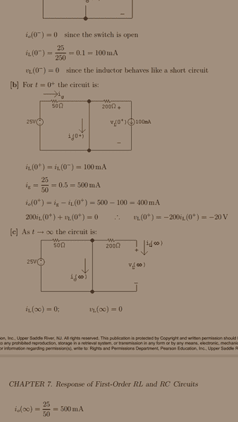

abdullah khaled Messages 6 Reaction score 0 Mar 24, 2018 #3 phinds said: Well, what do you think would make them independent or dependent? I think they will be independent because ΔV on the short circuit will be 0 but at (b) here solution made I2 depends on 1 and I don't know why Attachments Screenshot_2018-03-24-22-04-27.png 12.3 KB · Views: 379

phinds Science Advisor Insights Author Gold Member Dearly Missed Messages 19,385 Reaction score 15,623 Mar 24, 2018 #4 How about the fact that they both flow through the same element? Does that not connect them in some way? Or put another way, are the two currents totally isolated from each other?
