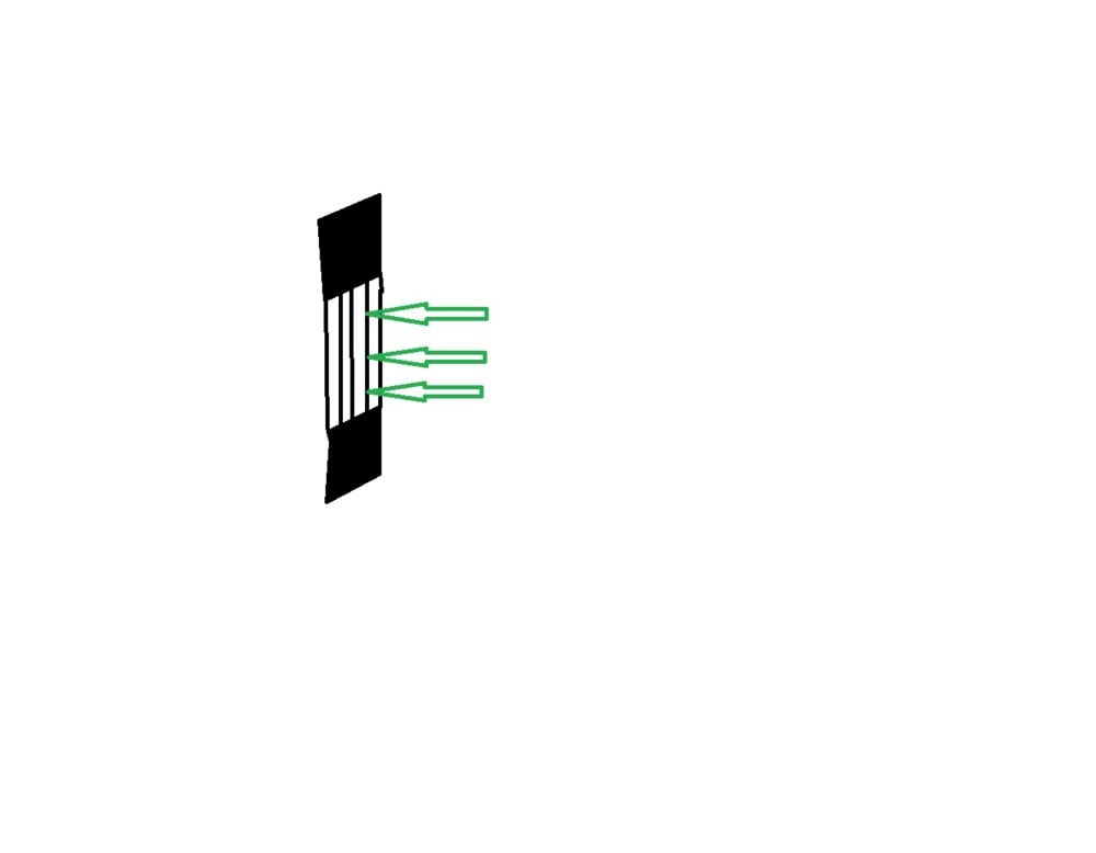

Hi, I have a theoretical problem, I am wondering would it be possible to cancel the otherwise induced currents within a planar sheet/foil conductor.
Diagram of a flat conducting strip with solid black end sections and a middle section split into several thin parallel conductor strips, with three green arrows pointing horizontally into the middle section.
you can see in the image I have a flattened conducting sheet which in the middle is split up in individual smaller conductors (for the sake of minimizing eddy currents) the middle is also the part which has a changing B field going through it.
But even with the individual conductors I suppose there would be a loop current in the outermost conductors, how could I cancel this unwanted effect?
By my humble opinion in this configuration the voltage/current on/through the endpoints is not effected.
Are you sure you have to care?
I too think you are right that it doesn't have an effect on the up/down or down/up vertical flow of current but such eddy currents would heat up the affected middle part more and probably most importantly weaken the B field passing through the middle by creating an opposing B field due to Lenz's law.

Each opening that has flux will have a circulating peripheral current. Those directional currents will cancel on the internal bars, but will not cancel for the two outermost bars.
1. By replacing the bars with a single thick bar there will be no eddy currents.
2. The holes should all have the same peripheral currents, so the currents will cancel exactly. The areas should carry the same flux. The outer bars should be thicker so they can carry the current without getting too hot.

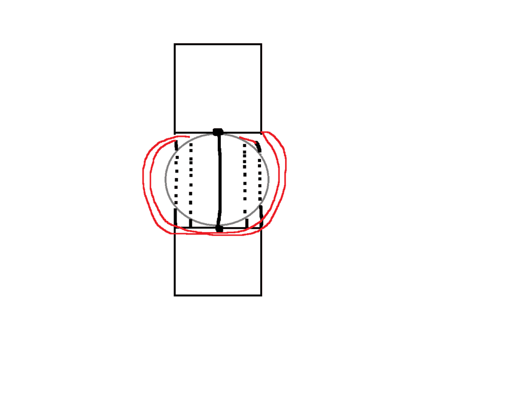

Now I hope you can understand from my attached drawing my idea, in any case I simply connect the central wire and let it span the entire flux area but as for the side wires, I either loop them around the solenoid in a single loop or loop each sides side wire around in an opposing manner,
If I loop the wires all around the same loop then what I could expect is that if the waveforms are identical of both the current carrying sheet and the coil driving the flux through the core that cuts it that then I would get constructive interference where the side wires get added induced emf that adds to the one already present within them right ?
if I wire the side wires where each side loops in opposite direction around the core then I guess I cancel both any constructive interference as well as any possible eddy currents?

I have no idea what you are trying to do.
Just think of a flat sheet like wire passing an area of AC flux perpendicular to the sheet, in that particular area in order to minimize the eddy currents one divides the sheet into individual bars/wires but still the outermost wires constitute a circulating current , so instead of the wires directly connecting back to the conducting sheet they make a single loop around the flux and only then connect to the sheet.
so in this way any opposing eddy currents get cancelled
As I see it, if you cut and reroute the outer bars to cancel their current, the current imbalance situation simply moves into the next pair of bars. The only solution is to have one bar without a hole. Cut and don't reroute the outer bars.
one bar without a hole I suppose you mean to have simply one wire positioned in the middle and the outer bars basically should be taken away because if they don't form part of the circuit then they have no other use.
Now but I wonder say if I have only 3 strips of wire (bars) one in the middle and one at each outermost side , now the middle bar is safe from eddy currents so if we then reroute the outermost bars so that any unwanted induced current through them cancels , why would that make the situation worse? because the way I understand it is that the highest current always forms around the outermost parts of a conducting loop since those parts have the greatest number of flux lines through the loop, so if the outer parts are taken care of then the inner parts shouldn't be a worry?

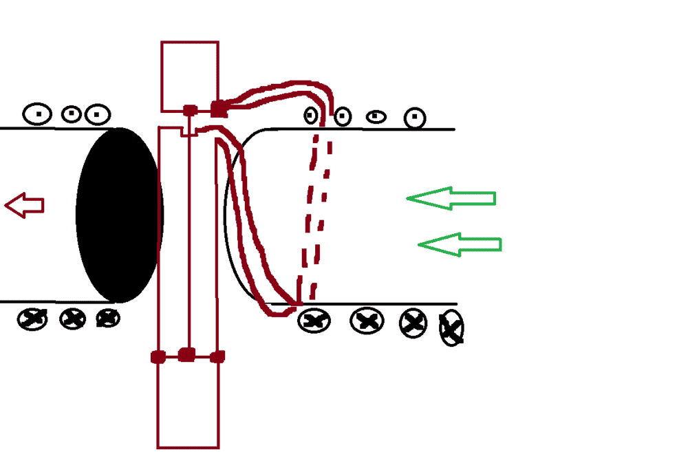

Ok let me ask like this again with an added drawing, is it possible to cancel the eddy loop current that would otherwise form if the sidebars were connected directly from the lower to the upper sheet conductor by simply wrapping them around the very core which holds the flux that creates the eddy currents in the first place?
Now if I am not mistaken then eddy currents form in a similar way a current forms in a transformer's secondary winding, aka 180 degrees out of phase or in opposite direction than primary current in order to oppose the primary current?
So by wrapping the outer bar wires around the core in the opposite direction than the primary winding the currents from eddies and the loop should cancel, although given that the current in each sidewire is looped around the core in the same way and together that alone I think should mostly cancel any currents that would want to run in opposite directions in each of the wires should it not?

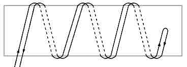

You appear to be fascinated by increasing the complexity to the point where you cannot understand the situation.
You need to study the theory of knots. You are designing a magicians slip-knot, that is not a knot. When you pull on the ends the knot disappears and you have no topological difference.
So why try to invent an involved cancellation, for the sake of cancellation, if you end up with the equivalent of zero? You may as well reduce the complexity to the zero it is, by deleting the whole thing.

The induced current in the conductive path shown in the drawing should be substantially eliminated or at least to some extent cancelled.
But this is just fundamental behavior of electric circuit, nothing special.
Besides, I prefer to call it induced current rather than eddy current.
