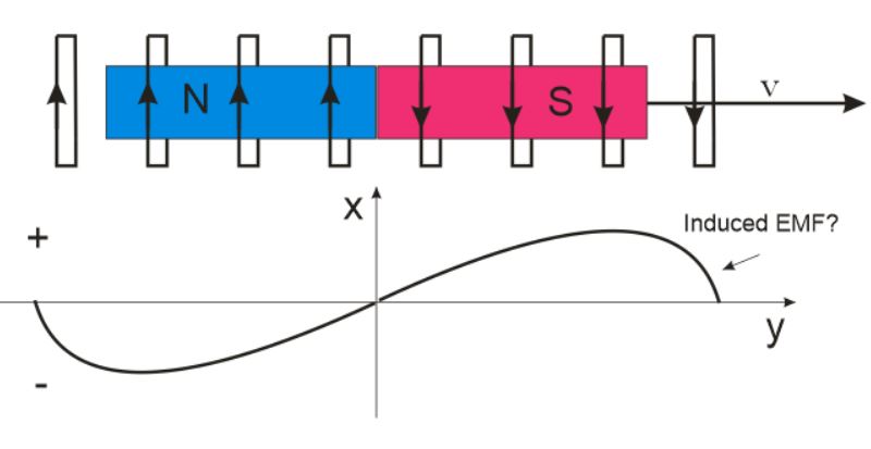

I wonder if there is a way to calculate induced EMF in closed loops around bar magnet, which is traveling with constant velocity v to the right as depicted?

The turns are representing single loop of coil around the bar magnet. I would like to know; what amount of electricity is induced in single loop of solenoid when it is approaching toward the center of bar magnet. What I know is that the center of bar magnet is not susceptible to ferromagnetic materials. Preferably I would like to see the plot, what it is look like. The graph below is my artistic view of my problem.

Won't get much emf if they are shorted turns.
Is that really so?
Isn't the induced emf exactly the same, whatever the resistance of the loop?
I actually get very confused about this, becuse a change of flux in the loop will cause an emf, the emf will generate a current in the loop, the current will create a magnetic field opposing the change of flux, so there will be less change of flux than you first thought, so there is less emf, less current, less magnetic field and now we can have a big change of flux again, etc. ad nauseum. (because I get giddy. Not an expression of distaste or whatever.)
So I just think the emf will be that given by the change of flux from the moving magnet or primary coil or whatever, E=dΦ/dt for a closed loop of any resistance.
I'd be hard pressed to say how the flux & emf vary along the magnet, except to agree with your zero and change of polarity near the centre.
Outside I find your sudden drop to zero emf surprising. I'd have thought the field stretches out to ∞, so you'll always have some tiny emf. I'd want to draw it more like an exponential fall off in emf as you move away from the magnet. Or inverse square maybe.

Yes there is a way to calculate the EMF => Faraday's law of induction.
Then applying that you would first need to plot or estimate your flux lines, then determine the rate of change of flux as the coil moves.
Very important thing to consider is that magnetic fields (and therefore the flux) interact with other magnetic fields, as well as any materials that have a relative permeability other than 1.
So your estimate is about right for a bar magnet in free space. Note if your coils are shorted turns, then the induced EMF will cause current to flow (I=V/R) which will develop its own field opposing the driving change of flux => now requires a force to move (the basis of a hysteresis brake) and changes the shape of the flux around it.
If you have zero volts generated, that just means your rate of change of flux is zero, this is not necessarily a magnetic zero, your coil may just be traveling parallel to the flux...
