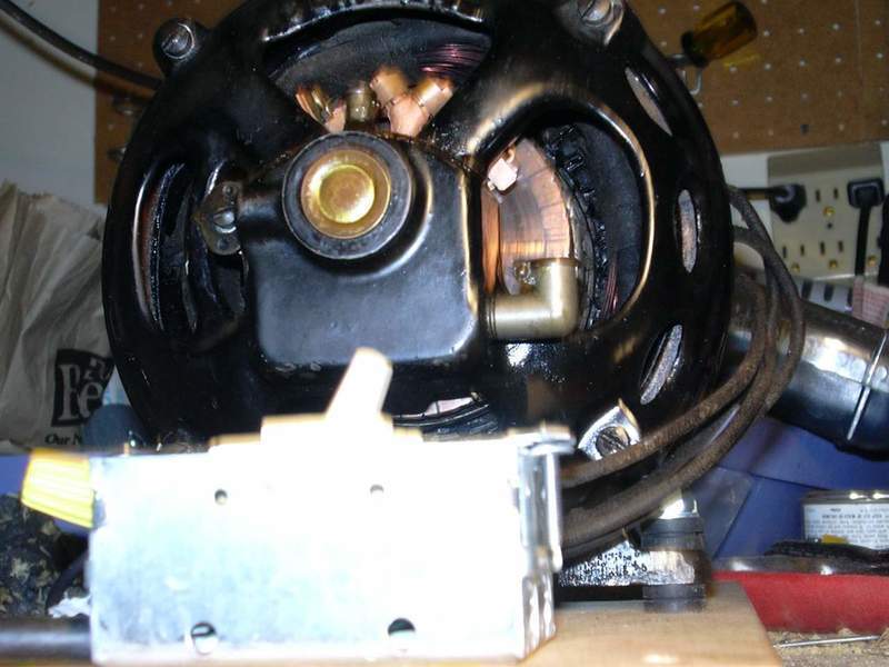

I am using a 1/4 HP 4-pole repulsion-start, induction-run motor on a buffer/grinder, and a 1/2 HP repusion start, induction run motor on a 14" bandsaw. One (Century Electric, patent date 1915) has a radial commutator (see picture). It has higher torque and lower starting current than a similar capacitor-start motor. The repulsion-start motors have a second squirrel cage that is selectively shorted by the brushes on the repulsion-start commutator.
