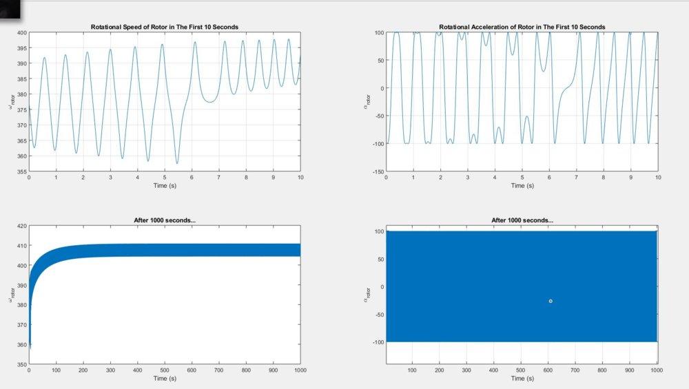

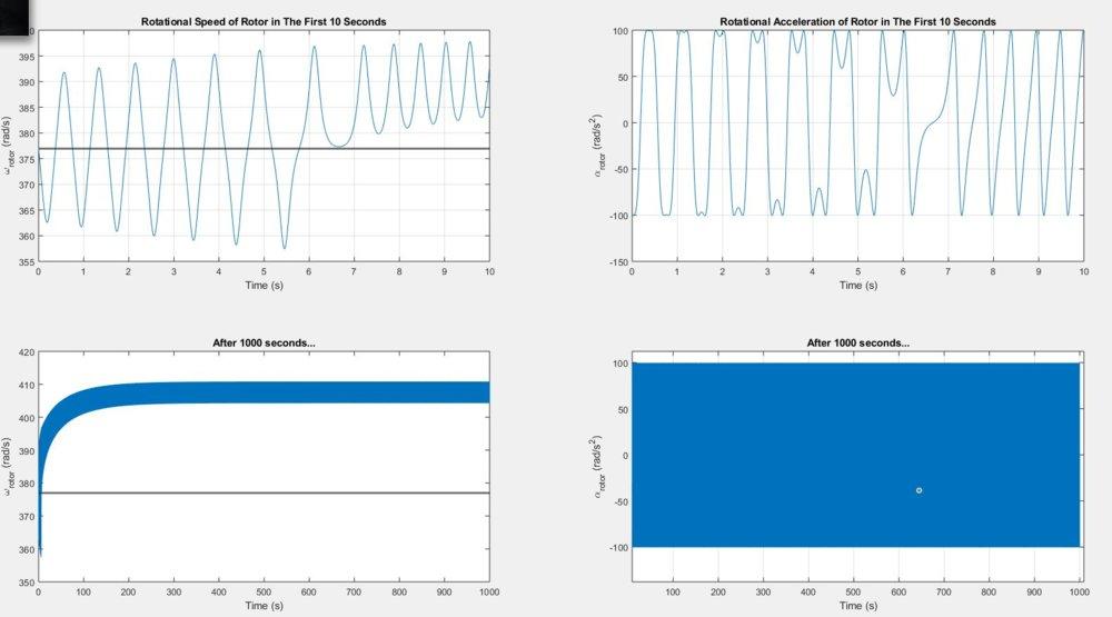

Again. I can share with you the MATLAB code I wrote to implement this. And actually, I also use the drawnow function of MATLAB so that I can also see the vectors in 3d space along with the data play out after it's been computed which helps make sure the result make some sense and is also just pretty cool to see.
So, as one possible scenario, I set it up so that the initial rotational speed of my rotor was AT synchronous speed (I set that as 60Hz on a two-pole machine), which was what I was initially curious about to begin with, and had the initial angle be 90 degrees. Now there's A LOT of other parameters going on, and it would be insane to try and show you everything. Here's a setup with some friction, the rotor having some decent moment of inertia, and decent magnetic fields, over 1000s:
Four-panel MATLAB figure of a rotor's rotational speed and acceleration over 10 seconds and over 1000 seconds, with a horizontal reference line near 377 rad/s; the 1000-second acceleration panel is a dense band between -100 and 100 rad/s^2.
The graphs on the left are for the rotational speed of the rotor ##\omega_{rotor}## and the graphs on the right are for the angular acceleration of the rotor ##\alpha_{rotor}##. And what I meant by the visualization (I uploaded to YouTube a 20 second thing to show you here more clearly: quick example).
Firstly, it's clear there is definitely some oscillation about synchronous frequency (the grey line for the graphs on the left), and the angular acceleration (which you can of course also see takes the same shape as the torque) is constantly oscillating all throughout. Furthermore, in this setup, the motor's steady state speed was actually HIGHER than synchronous speed.
Now I'm just showing this example as where you might yourself explore this so you can get more insight. I am certainly not saying my simulation is fully complete, because it is clearly evident experimentally that synchronous speed is the speed the rotor spins at without much oscillation. So it's a matter of improving the model, but that improvement will definitely not come about from my current textbook, because purely based on ##\vec \tau_{ind} = k \vec B_{rotor} \times \vec B_{stator}##, I am not getting the actual expected behavior! However, once that is done, you can see that I will be able to have a more accurate picture of transient and steady state behavior, and also gain the insight that comes with playing around with all these parameters! Looking forward to that as I increase my knowledge on the field, and all the while, this invaluable tool of simulation will surely come in handy TONS.
  • Four MATLAB plots in a 2x2 grid: rotational speed of rotor (deg/s, about 357 to 399) and rotational acceleration of rotor (about -100 to 100) against time for the first 10 seconds, and the same two quantities plotted after 1000 seconds, with speed levelling off near 405 to 410.
