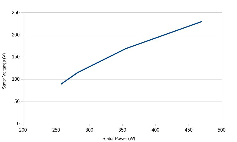

This is where i have become a bit confused. I have plotted my own curve (used to answer question i.) using the data given and i am unsure how you have managed to conclude the wining and friction losses from this graph?
  • Line graph of Stator Voltages (V) against Stator Power (W), y-axis 0 to 250, x-axis 200 to 500; a single curve rises concavely from about 258 W at 89 V to about 470 W at 230 V.

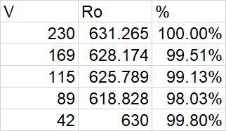

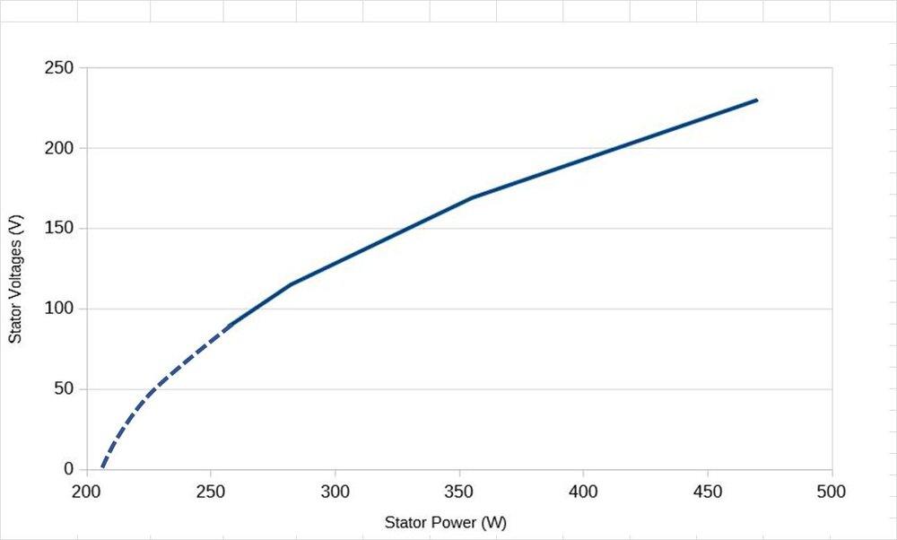

Calculating Ro then 218.6 W for windage and friction it is the value for which the Ro is almost constant.
V=230 Ptot=470 W Pmag=(470-218.6)=251.4 Ro=3*230^2/251.4= 631.26 ohm
  • Line graph of stator voltages in volts against stator power in watts, rising in a concave curve from about 207 W at 0 V to about 470 W at 230 V; the start is dashed and the rest solid.
  • Table with columns V, Ro and %: rows read V 230 Ro 631.265 100.00%, 169 628.174 99.51%, 115 625.789 99.13%, 89 618.828 98.03%, 42 630 99.80%.

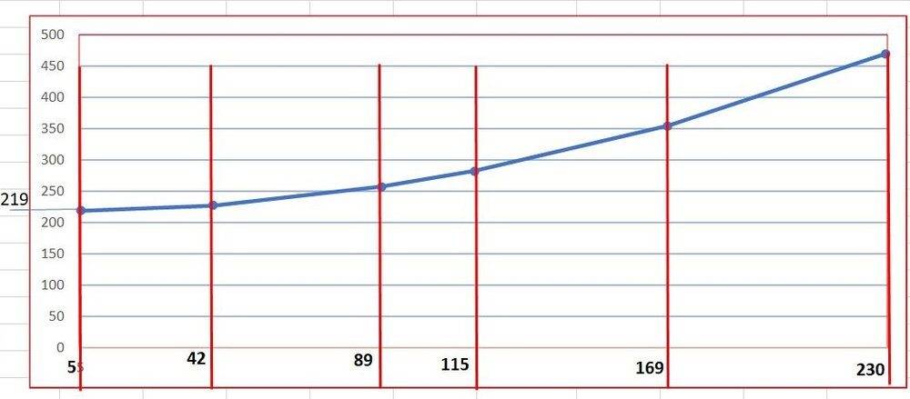

I think it is better to switch the coordinates
  • Line graph in Excel of a rising blue curve with markers at six points, with vertical red lines dropping to x-axis values 55, 42, 89, 115, 169 and 230. The y-axis runs from 0 to 500 and the curve starts near 219 and ends near 470.
