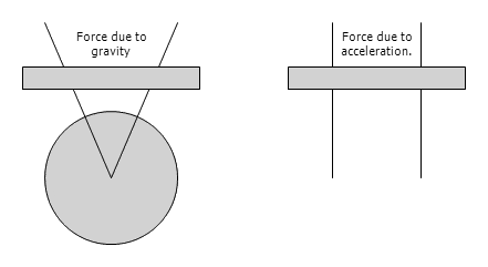

But you can determine, through experimentation, if a force is due to gravity or acceleration. Example: Two plum lines separated by a distance will not be parallel in the case of gravity, but they will be in the case of linear acceleration.
I agree with A.T. Real forces are those that obey Newtons laws. However, it really depends on how precise you need to be. Your experiments may show that all forces and motions obey Newtons laws. But upon more precise measurements you will discover that they do not. There are no real perfect inertial frames. Or, maybe there are. We just don't know where they're at.
-In the "force due to acceleration" picture , if you would put a mass sufficiently far away , the lines of force would be almost parallel, so ¿could you distinguish it from a force due to acceleartion?.
Perhaps the solution is what you say about what level of precision we want, but I suppose that practically it would be very difficult to measure that.

jonjacson said:
-In the "force due to acceleration" picture , if you would put a mass sufficiently far away , the lines of force would be almost parallel, so ¿could you distinguish it from a force due to acceleration?.
Yes, it depends on what the precision requirements are. There are also other ways to detect whether a force is due to gravity or acceleration. The force of gravity decreases according to the square of the distance. If you're standing on the 1st floor of a high rise building, then you will have more force than if you were standing on the top floor. However, if the building were being accelerated by a rocket then the force would be equal on all floors. And there are tidal forces associated with gravity, although those would be even more difficult to detect.
