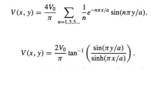

I'm having trouble beginning this...

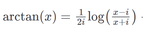

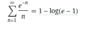

I'm trying to get from the formula in the top to the formula in the bottom (See image: Series). My approach was to complexify the sine term and then use the fact that (see image: Series 1) for the infinite sum of 1/ne^-n. Then use the identity (see image: Series 2). Any other ideas?
  • Infinite series sum from n=1 to infinity of e^(-n)/n equals 1 - log(e - 1).

  • Equation: arctan(x) = (1/(2i)) log((x - i)/(x + i)), with the formula typeset in LaTeX-style math.

  • Two equations: V(x, y) = (4V0/π) times the sum over odd n from 1 to infinity of (1/n) e^(-nπx/a) sin(nπy/a), and V(x, y) = (2V0/π) tan^-1( sin(πy/a) / sinh(πx/a) ).

Let ##f(x)=\sum_{n=1}^\infty \frac{e^{-nx}}{n}##. Then ##f'(x)=\sum_{n=1}^\infty e^{-nx}=\frac{1}{e^x-1}##. Integrate to get ##f(x)=x-ln(e^x-1)##. When ##x=1##, we get ##f(1)=1-ln(e-1)##.

We seek a closed form solution to the potential,
V(x,y)=\frac{4V_0}{\pi}S_n
S_n=\sum_{n=0}^{\infty}\frac{e^{-(2n+1)\frac{\pi}{a}x}\sin((2n+1)\frac{\pi}{a}y)}{(2n+1)}
I make the substitutions ##z=\frac{\pi}{a}(x+iy)## and ##\bar z=\frac{\pi}{a}(x-iy)## which scales the complex plane by ##\frac{\pi}{a}##. We now have

The ##\arctan(x)## can be expressed as
\arctan(x)=\frac{1}{2i}(\frac{i-x}{i+x})
and taking the principle branch of the logarithm we have
S_n=\frac{1}{2}\left [ \frac{\pi}{2}-\arctan(\frac{\sinh(\frac{\pi}{a}x)}{\sin(\frac{\pi}{a}y)})\right ]
V(x,y)=\frac{2V_0}{\pi}\left [\frac{\pi}{2}-\arctan(\frac{\sinh(\frac{\pi}{a}x)}{\sin(\frac{\pi}{a}y)})\right ]
