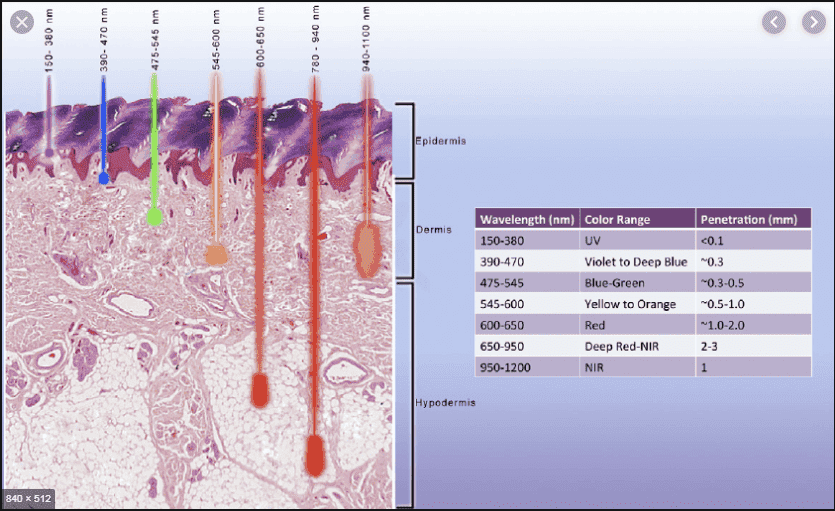

Exactly what you want to heat and how could be important. Theraputic heat treatment (cannot remember the fancy name) uses IR, rather than just light because they claim it 'penetrates better' without 'burning'. Shorter wavelengths from a high power lamp may heat just the surface when that's not necessarily what you want. Of course a red hot element will be the right temperature and last longer than a lamp.
Was curious so had to go look, seems that penetrating the skin thing is a fairly narrow band, most likely due to the red color of our working fluid.
