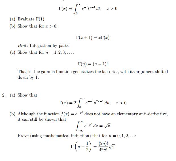

Need help on exercise 2 from the linked image , left first in so you guys could see the Γ(χ) function any help is appreciated , thanks in advance!
  • Printed exercise sheet: definition of the gamma function as an integral from 0 to infinity of e^(-t) t^(x-1) dt for x > 0, parts (a) to (c), and exercise 2 with the substitution form and the Gaussian integral result.

2.(a) Apply the substitution $t=u^2$ for $\Gamma(x)$.
2.(b) Can you show where you're stuck?

Ok i did a and n b i proved it for n=0 assumed for n=k and used the fact that
Γ(x+1)=xΓ(χ) when calculating Γ(χ+1+ 1/2) but could not find a way το prove that it is equal with what one gets just by plugging n=k+1 in the statement that we want to prove

Use 1(b) to write
$$\Gamma\Bigl((k + 1) + \frac{1}{2}\Bigr) = \Gamma\left(\Bigl(k + \frac{1}{2}\Bigr) + 1\right) = \Bigl(k + \frac{1}{2}\Bigr) \Gamma\Bigl(k + \frac{1}{2}\Bigr),$$
and then use the induction hypothesis
$$\Gamma\Bigl(k + \frac{1}{2}\Bigr) = \frac{(2k)!}{4^k k!}\sqrt{\pi}.$$

Yes that is as far as i go but how is that equal to the statement for n=k+1

I gave you a hint to solve the problem. You now have to show
$$ \Bigl(k + \frac{1}{2}\Bigr)\frac{(2k)!}{4^k k!}\sqrt{\pi} = \frac{(2k+2)!}{4^{k+1} (k+1)!}\sqrt{\pi}.$$
To do so, write $k + \frac{1}{2} = \frac{2k + 1}{2}$ and use the identity
$$\frac{1}{2} = \frac{2k + 2}{4(k + 1)}.$$

Wow that was kinda simple , i def need more practice manipulating factorials , thanks for the help man.
