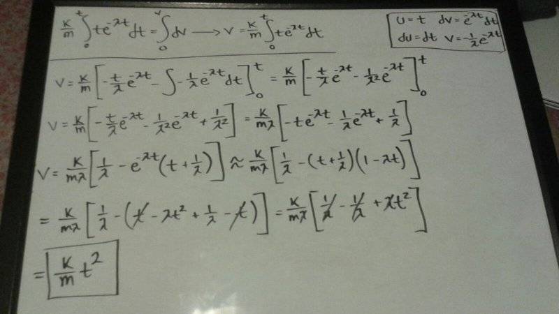

An object of mass m is initially at rest and is subject to a time-dependent force given by F = kte^(-λt), where k and λ are constants.
a) Find v(t) and x(t).
b) Show for small t that v = 1/2 *k/m t^2 and x = 1/6 *k/m t^3.
c) Find the object’s terminal velocity.
I showed my work for finding v(t) and getting the approximation for v(t) for small t. but I am missing the 1/2 at the front and I can't seem to find where it comes from.
  • Handwritten derivation on a whiteboard: integration by parts of k/m times the integral of t e^(-λt) dt, with a series of steps leading to v = k/m t^2 in a boxed final line.
Perhaps you need to further develop ##e^{-\lambda t}## ? The term linear in ##t## cancels, so you need to develop up to ##t^2##
BvU said:
Perhaps you need to further develop ##e^{-\lambda t}## ? The term ilinear in ##t## cancels, so you need to develop up to ##t^2##
but if I include a t^2 term then I end up with a t^3 term that doesn't cancel
Yes. So the outcome will be correct up to order ##t^2##. .
You can also do the development before the integration: ## t\;e^{-\lambda t}= t -\lambda t^2 ## and ignore higher orders
Thanks for your help, i got the right answer. But can you help me understand something, why is it enough to include only up to the t^1 term before the integration, but after the integration we have to include the t^2 term?
"Integration increases order of ##t## by one" is the answer that comes to mind. But I agree with you that it makes a weird impression.
