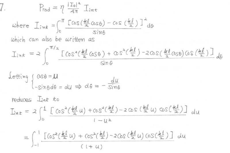

I am having some sort of blindness today! I just don't see how I can go from the first step to the second:
[tex]2\int_0^1\frac{[\cos^2 (au) +\cos^2a-2\cos (au) \cos a]}{1-u^2} du = \int_{-1}^1\frac{[\cos^2 (au) +\cos^2a-2\cos (au) \cos a]}{1+u} du[/tex]
Where "a" is just a constant.
As you can see, the numerator does not change. so it really boils down to
[tex]2\int_0^1\frac{1}{1-u^2} du = \int_{-1}^1\frac{1}{1+u} du[/tex]
I tried using partial fraction where:
[tex]\frac 1 { (1+u)(1-u)}=\frac A {(1+u)}+\frac B {(1-u)}[/tex]
where A=B=##\frac 1 2##.
[tex]\Rightarrow\; 2\int_0^1\frac{1}{1-u^2} du=\int_0^1\frac{1}{1+u} du+\int_0^1\frac{1}{1-u} du[/tex]
I just don't see it. Please help.

I get to this directly from what is given from the solution manual:
[tex]\Rightarrow\;2\int_0^1\frac{1}{1-u^2}[\cos^2 (au) +\cos^2a-2\cos (au) \cos a] du = \int_{-1}^1\frac{1}{1+u} [\cos^2 (au) +\cos^2a-2\cos (au) \cos a]du[/tex]
As you can see, the numerator does not change. I just remove the whole numerator and boils down to
I really did not change anything. I just don't get this and I show my work in the first post where I got stuck. I don't even see why I need to worry about sine and cosine terms in the numerator as it is not even affected. I only show the whole equation just to show where it comes from.

Actually that's where it came from...##(\cos au -\cos a)^2##.
I am still looking at this, I understand what I did wrong. But I still have no idea how to solve this.
Dick said:
You are barking up the wrong tree here. Saying that the integral of 1/g(x) is equal to the integral of 1/h(x) means that the integral of f(x)/g(x) equals the integral f(x)/h(x) is completely wrong. Not that I know how to solve your problem, but the integral of 1/(1+u) from -1 to 1 doesn't even exist. And the other one diverges as well. You can't 'cancel' the numerator.
I see what you mean. But now I am even more lost. This is a scan of the solution manual. I use a=kl/2.
Use the difference to product identity for ##\ \cos(\theta) - \cos(\varphi) \ .##
##\displaystyle
\cos \theta - \cos \varphi = -2\sin\left( {\theta + \varphi \over 2}\right) \sin\left({\theta - \varphi \over 2}\right)
In this case, ##\displaystyle \ {\theta + \varphi \over 2}\ ## and ##\displaystyle \ {\theta - \varphi \over 2}\ ## work out very nicely .
Added in Edit:
The only reason to change to the product of sines is to show that the limit of the integrand exists as u → ±1 .
Using the partial fraction decomposition you found for 1/(1-u2) , split the integral into the sum of two integrals, one with a denominator
of 1 + u, the other with 1 - u.
Each, of course, has a numerator of (cos(au)-cos(a))2 .
Then, for the integral with a denominator of 1 - u, do a substitution such as x = -u .
Thanks
Let me work on this and come back later.
Let me try this and see whether this is right
[tex]\frac 2 { (1+u)(1-u)}=\frac A {(1+u)}+\frac B {(1-u)}=\frac 1 {(1+u)}+\frac 1 {(1-u)}[/tex]
[tex]\Rightarrow\;2\int_0^1\frac{[\cos^2 (au) +\cos^2a-2\cos (au) \cos a]}{1-u^2} du = \int_{0}^1\frac{[\cos^2 (au) +\cos^2a-2\cos (au) \cos a]}{1+u} du\;+\; \int_{0}^1\frac{[\cos^2 (au) +\cos^2a-2\cos (au) \cos a]}{1-u} du[/tex]
[tex]\hbox {Let}\;v=-u\Rightarrow\; du=-dv[/tex]
[tex]\int_{0}^1\frac{[\cos^2 (au) +\cos^2a-2\cos (au) \cos a]}{1-u} du\;=\;-\int_{0}^{-1}\frac{[\cos^2 (-av) +\cos^2a-2\cos (-av) \cos a]}{1+v} dv\;=\;\int_{-1}^0\frac{[\cos^2 (av) +\cos^2a-2\cos (av) \cos a]}{1+v} dv[/tex][tex]\hbox {Let}\;u=v\Rightarrow\; du=dv[/tex]
[tex]\int_{-1}^0\frac{[\cos^2 (av) +\cos^2a-2\cos (av) \cos a]}{1+v} dv\;=\;\int_{-1}^0\frac{[\cos^2 (au) +\cos^2a-2\cos (au) \cos a]}{1+u} du[/tex]
Therefore
[tex]2\int_0^1\frac{[\cos^2 (au) +\cos^2a-2\cos (au) \cos a]}{1-u^2} du\;=\;\int_{0}^1\frac{[\cos^2 (au) +\cos^2a-2\cos (au) \cos a]}{1+u} du\;+\;\int_{-1}^0\frac{[\cos^2 (au) +\cos^2a-2\cos (au) \cos a]}{1+u} du[/tex]
[tex]\Rightarrow\;2\int_0^1\frac{[\cos^2 (au) +\cos^2a-2\cos (au) \cos a]}{1-u^2} du\;=\;\int_{-1}^1\frac{[\cos^2 (au) +\cos^2a-2\cos (au) \cos a]}{1+u} du[/tex]
How does this look?
...[tex]\hbox {Let}\;v=-u\Rightarrow\; du=-dv[/tex]
[tex]\int_{0}^1\frac{[\cos^2 (au) +\cos^2a-2\cos (au) \cos a]}{1-u} du\;=\;-\int_{0}^{-1}\frac{[\cos^2 (-av) +\cos^2a-2\cos (-av) \cos a]}{1+v} dv\;=\;\int_{-1}^0\frac{[\cos^2 (av) +\cos^2a-2\cos (av) \cos a]}{1+v} dv[/tex]...
Therefore
How does this look?
It looks good to me.

Thanks for the help from everybody.
SteamKing said:
I agree that 1/(1+u) + 1/(1-u) = 2 / (1-u^2), but his partial fraction decomp says that his unknowns A = B = 1/2, which is incorrect according to his initial assumption. It is a minor point, but one should endeavor to be correct in all details.
It was late, I was sloppy, it should be ##2\frac 1 {1-u^2}## and A=B=##\frac 1 2##.

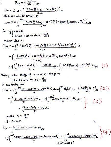

This is a new question all together, but it is on the same page of the derivation. I cannot follow the derivation of the notes. Here is my derivation starting from (1) or the notes.
[tex]I_{int}=\frac 1 2 \int_{-1}^1\frac{[1+\cos(klu)+1+\cos(kl)]}{(1+u)}du\;-\;\int_{-1}^1\frac{\cos\left (\frac{kl}{2}(1+u)\right)+\cos\left (\frac{kl}{2}(1-u)\right) }{(1+u)}du[/tex]
[tex]\hbox {Let }\;(1+u)kl=v\;\Rightarrow\;v=(kl+klu),\;u=(\frac {v}{kl}-1),\;(1+u)=\frac {v}{kl}, \;\hbox { and } \;du=\frac {dv}{kl}[/tex]
[tex]\Rightarrow\; I_{int}=\frac 1 2 \int_0^{2kl} \frac {[2 + \cos (v-kl)+\cos(kl)]}{v} dv-\int_0^{2kl}\frac{\cos\left(\frac v 2 \right)}{v}dv-\int_{-1}^1 \frac{\cos\left[\frac{kl}{2}(1-u)\right]}{1+u}du[/tex]
[tex]\hbox {For the second term, let }\; w=\frac v 2 \;\hbox { and then Let } v=w \hbox { later}[/tex]
[tex]\Rightarrow\; I_{int}=\frac 1 2 \int_0^{2kl} \frac {[2 + \cos (v-kl)+\cos(kl)]}{v} dv-\int_0^{kl}\frac{\cos(v)}{v}dv-\int_{-1}^1 \frac{\cos\left[\frac{kl}{2}(1-u)\right]}{1+u}du[/tex]
[tex]\Rightarrow\; I_{int}=\frac 1 2 \int_0^{2kl} \frac {[2 +\cos(kl)]}{v} dv+ \frac 1 2 \int_0^{2kl} \frac { \cos (v-kl)}{v} dv -\int_0^{kl}\frac{\cos(v)}{v}dv-\int_{-1}^1 \frac{\cos\left[\frac{kl}{2}(1-u)\right]}{1+u}du[/tex]
Now compare the line (2) in the scanned notes:
[tex]\Rightarrow\; I_{int}=\frac 1 2 \int_0^{2kl} \frac {[2 + \cos (klv)+\cos(kl)]}{v} dv-\int_0^{kl}\frac{\cos(v)}{v}dv-\int_{-1}^1 \frac{\cos\left[\frac{kl}{2}(1-u)\right]}{1+u}du[/tex]
[tex]\Rightarrow\; I_{int}=\frac 1 2 \int_0^{2kl} \frac {[2 +\cos(kl)]}{v} dv+ \frac 1 2 \int_0^{2kl} \frac { \cos (klv)}{v} dv -\int_0^{kl}\frac{\cos(v)}{v}dv-\int_{-1}^1 \frac{\cos\left[\frac{kl}{2}(1-u)\right]}{1+u}du[/tex]
If you compare the equation I derive with (2) of the notes, the only terms that is different is:
[tex]\frac 1 2 \int_0^{2kl} \frac { \cos (v-kl)}{v} dv\;\hbox { from my equation to }\;\frac 1 2 \int_0^{2kl} \frac { \cos (klv)}{v} dv\;\hbox { from the notes.}[/tex]
I just don't see how I can get the answer from the notes. As you see, I separate the longer integration into two parts. I am pretty sure I did this right this time...hopefully. Please help.
I attach the whole page of the notes as I might have more question coming and I might have typos. This is a difficult derivation that involve sine and cosine integral and I am rusty in math! I am not math major, I do this as part of the derivation of radiating power of antenna. I am not like you guys that are in "mid season condition"!:smile:. Everything is rusty for me and need some kick start! What I posted is from equation (1) to (2) in the notes.
