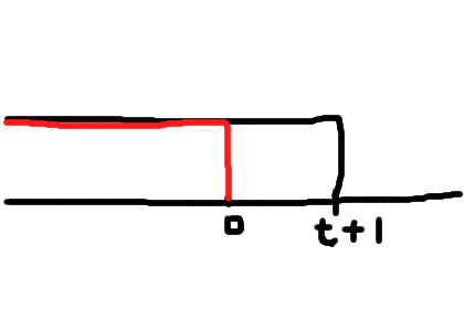

Ok, let me c if i got it correct, rewriting:
u(-(t+1)) - u(-t), I am attaching picture.. the first part of this expression is shown with black, the second part which is u(-t) is shown in red..
now its clear that integral limits are from 0 to t+1?
But.. however tho.. my original problem has exp(-j*w*t) inside the inegral... i put 'a' as constant just for simplification... but now, since my limit is t+1.. it turns out that i have to change variable? but that looks weird stil... because i don't think i was supposed to arrive to this..
Your picture in not correct.
u(-(t+1)) = 1 when t<= -1
u(-t) = 1 whe t<=0
When you substract u(-t) from u(-(t+1)) you should get zero everywhere except when -1<= t <=0 .
now i got it... thanks!

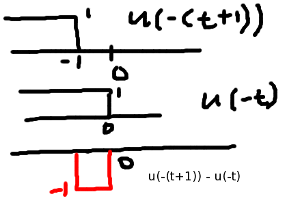

just one more thing regarding this problem... now that we know my integration limits are froom -1 to 0... should i place '-' sign inside the integral before constant 'a'? because the unit step is negative? or not?
i.e. should my integral be Int(-1,0 of: -a * dt) ?
Why do you think it is negative?
ok because of this:
i attached pic.
Good!
My work here is done; you are all set. :-)
lol what u mean? i stil didnt get something? i'd be happy if u point out what else am i missing? :)
stil have question... should i have Minus sign in front of 'a' in the integral then?
Nothing more. :-)
Your integral should be int of (-1 to 0) -a dt.
