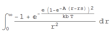

Hi,
I am trying to calculate second virial coefficient from interaction potentias and I have to Integrate at Infinity level and it seems that Integrate doesn't converge.
can you help me integrate this function. Integrate is attached as an image.

It looks like it would be difficult to integrate analytically. To check its behavior near r = 0, expand the numerator as a power series in r. The first term may be ~ r2, in which case you are OK. However I am not sure - it is messy.
If rs is not nul, the integral is not convergent.
So the integral can be computed only if rs=0

Why?
If rs is not nul, the function to be integrated is equivalent to c/r² close to r=0, where c is a constant (Expand the function around r=0).
The integral of c/r² is divergent for r tending to 0.
if rs=0 then c=0 and one can see from the expansion that the next term is integrable. So, there is no integration problem around r=0 in this particular case of rs=0.

My estimate is that the numerator is ~ r2 near r = 0, unless s = 1.

Does "rs" means r multiplied by s, or does "rs" is the symbol of a parameter (i.e. is constant) ?
In the first case you are right. In the second case I am right.
