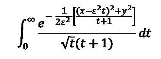

Hi,
I am wondering if it is possible to demonstrate that:
tends to
in the limit of both x and y going to infinity.
In this case, it is needed to introduce a measure of the error of the approximation, as the integral of the difference between the two functions? Can this be viewed as a norm in some space? Thanks in advance.

You are full right! It was my fault. Unfortunately, I cannot write formulae correctly in this forum, so I did a picture of my integrals, but the resolution was very bad.
The correct integrals are:
and
I lost the minus in the conversion process.
You can interpret x and y as related by the equation ##r^2 = x^2+y^2##.
For example, for ε = 0.01 (I am interested in the case where ε > 0), but the same happen for other values of ε, for x and y increasing along the diagonal, i.e. x = y, for x going from 0.005 to 0.6 with pass 0.05, the difference between the two integrals are:
##-0.771824, 0.00263352, 0.000352526, 0.000105135, 0.0000440287, 0.0000223273, 0.000012822,##
##8.04215 10^{-6}, 5.38984 10^{-6}, 3.80475 10^{-6}, 2.8007 10^{-6}, 2.13405 10^{-6}##
The same happens if x is constant and y increases, or if y is constant and x increases. As long as r increase the difference between the two integrals goes to zero.

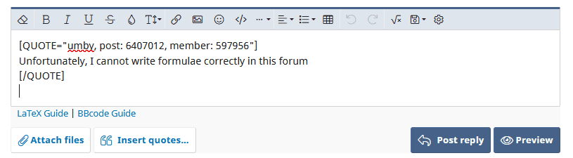

Click on the "LaTeX Guide" link at the lower left of the Edit window. That will show you how to post such equations using LaTeX. :smile:
thank you, it was helpful

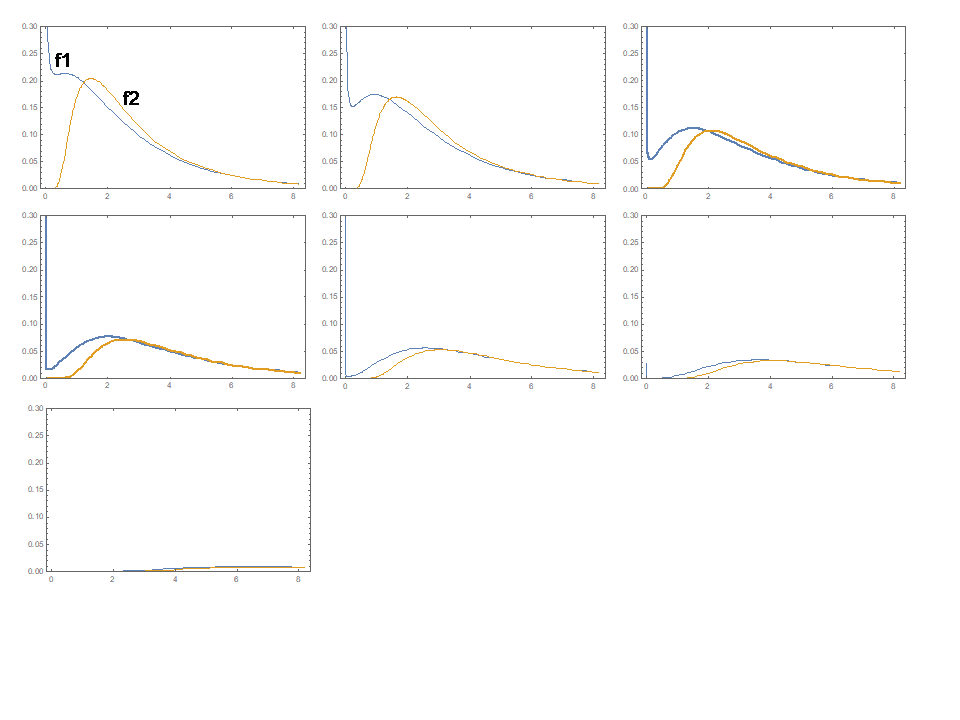

Let's call ##f1## the function:
\pmb{\text{f1}=\frac{\text{Exp}\left[-\frac{1 }{2 \epsilon ^2} \left(\frac{\left(x-\epsilon ^2 t \right)^2+y^2}{t +1}\right)\right]}{\sqrt{t} (t +1)}}\\##
And ##f2## the function:
##\pmb{\text{f2}=\frac{\text{Exp}\left[-\frac{1 }{2 \epsilon ^2} \left(\frac{\left(x-\epsilon ^2 t \right)^2+y^2}{t }\right)\right]}{\sqrt{t }t }}##
In the figure, plots of ##f1## and ##f2## are reported for increasing values of ##x## and ##y## (##f1## in blue ##f2## in red).
##f1## goes to infinity as ##t –> 0## and to 0 as ##t->\infty ##. Between the two asymptotic branches, ##f1## presents a bump. ##f2## goes to zero both as ##t –> 0## and as ##t->\infty ##. However, the asymptotic branch of ##f1## close to ##t = 0## becomes less and less important for the integration as ##x## and ##y## increase. At the same time, increasing ##x## and ##y##, the bump of ##f1## increases and the two functions get closer and closer. In this conditions, the difference between the two integrals progressively decreases. This is valid for any ##\epsilon>0## and if
##x## is constant and y increase,
##y## is constant and x increases,
both ##x## and ##y## increase.
It is possible to demonstrate this?
