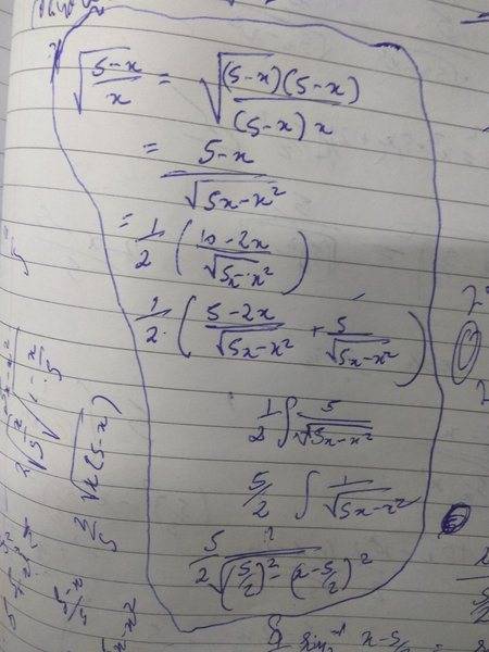

integration with respect to x
integral 1/sqrt (a^2 - x^2) = arcsin(x/a)
image attached, the arcsine term in 5/2 arcsin((2x-5)/5) it should be 5 arcsine(sqrt(x/5))

I think the arcsine formula for computing ##\int \frac{1}{\sqrt{(\frac{5}{2})^2-(x-\frac{5}{2})^2}}dx## cannot be applied because for x=0 the denominator goes to 0.

It would be far better to use Latex in order to be helped because checking through the attached image is somewhat hard.
Now, for the integral, I would hint in the way of substitutions with ##u = \frac{5 - x}{x}## being the most obvious. Have you tried this way?

Your image is an unreadable mess. I cannot tell what you think the final answer should be. Please take the trouble to type out at least your final answer.

When I plot those two functions in Mathematica, they appear to differ only by a constant, namely ##5\pi/4##.
You have the same issue for
$$\int \frac{dx}{\sqrt{1-x^2} } = \arcsin x + C$$ at ##x=\pm 1##.

Well for some reason I thought the domain of the function should contain 0, but now I understand this is not necessary. Should just state that the result holds for ##x\neq 0##
Yeiks, they look so different though. looks like constants do indeed make a huuuge difference. Thank you though, this was giving me a headache.

That substitution isn't working for me :/, I'm getting ## du =\frac{5}{x^2} dx## which gives me ## dx= \frac{1}{(u^2+1)^2} ## integral is this times a root u

Try the substitution ##u=\sqrt{\frac{5-x}{x}}##

This is u^2 =previous substitution . I'd get integral mentioned in previous reply but instead of multiplied by root u it'd be divided by 2 sqrt(u). any pointers on how i might use this more meaningfully?

What is x if ##u^2=\frac{5-x}{x}## and what is dx? Is there any square root in the integrand?

If you have an answer to an integral that you are not sure about, you can always differentiate it to see whether you get back the integrand.

A general trick is to try to get rid of the square root by making a variable substitution. In the case of [itex]\sqrt{\frac{5-x}{x}}[/itex], if you let [itex]x = 5 cos^2(\theta)[/itex], then this becomes: [itex]\sqrt{\frac{1-cos^2(\theta)}{cos^2(\theta)}} = \frac{sin(\theta)}{\cos(\theta)}[/itex]

The substitution works but if you find it difficult to follow then try what ehild suggests in post #11. If you find ##dx## and substitute in the original integral for the new variable you'll get a manageable integral.

integral is ## - \frac{2u^2du}{(u^2+1)^2} ## where u is what you suggested. This is to be followed by a substitution of u = tan z?

I used integration by parts . ##f '= \frac{2u}{(u^2+1)^2} ##, g=u.
