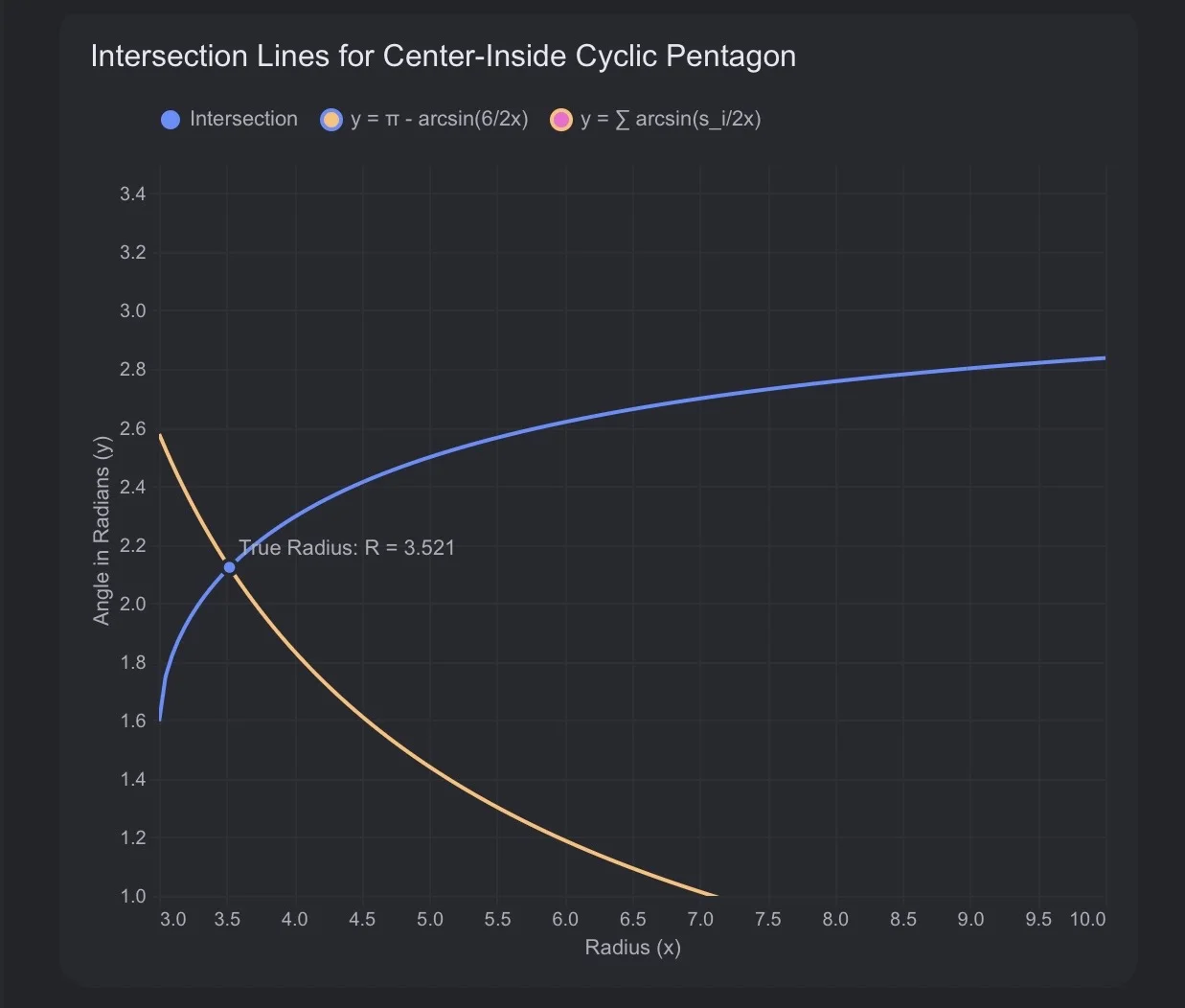

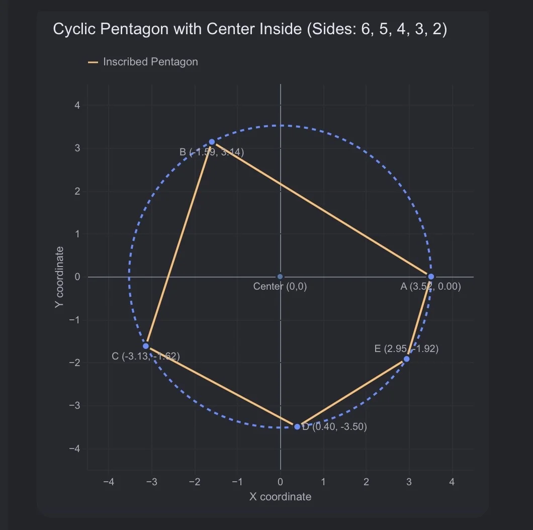

Here is an example for the case (2,3,4,5,6). In this case the sum angle is 2.578 rads which is greater than ##\frac{\pi}{2}## so the circle center is inside the polygon.
Plot of a cyclic pentagon with vertices A (3.52, 0.00), B (-1.59, 3.14), C (-3.13, -1.62), D (0.40, -3.50) and E (2.95, -1.92) inscribed in a dashed circle centred at the origin, with the centre marked inside the pentagon.
We use the equations from case 1 above to calculate the intersection.

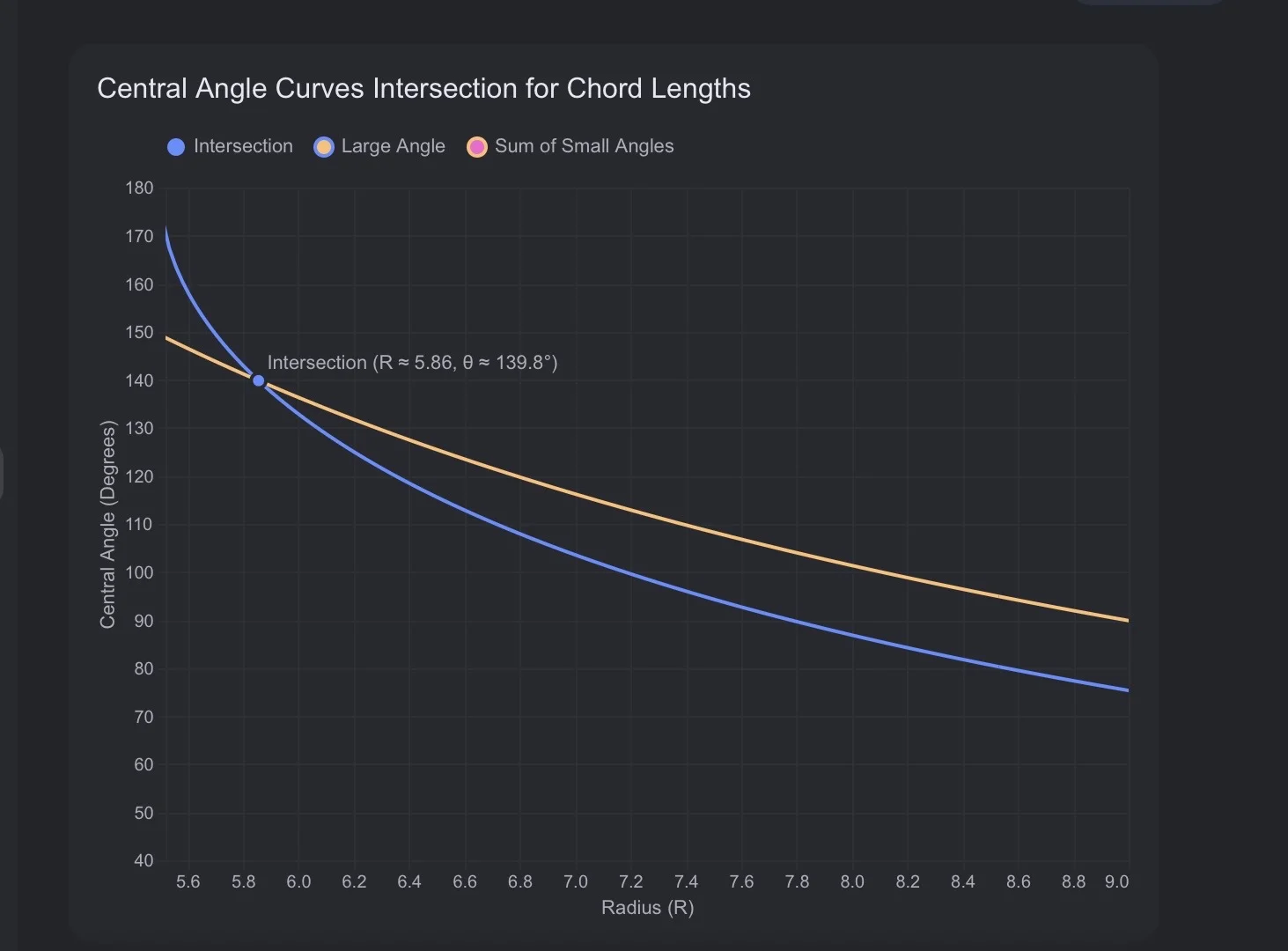

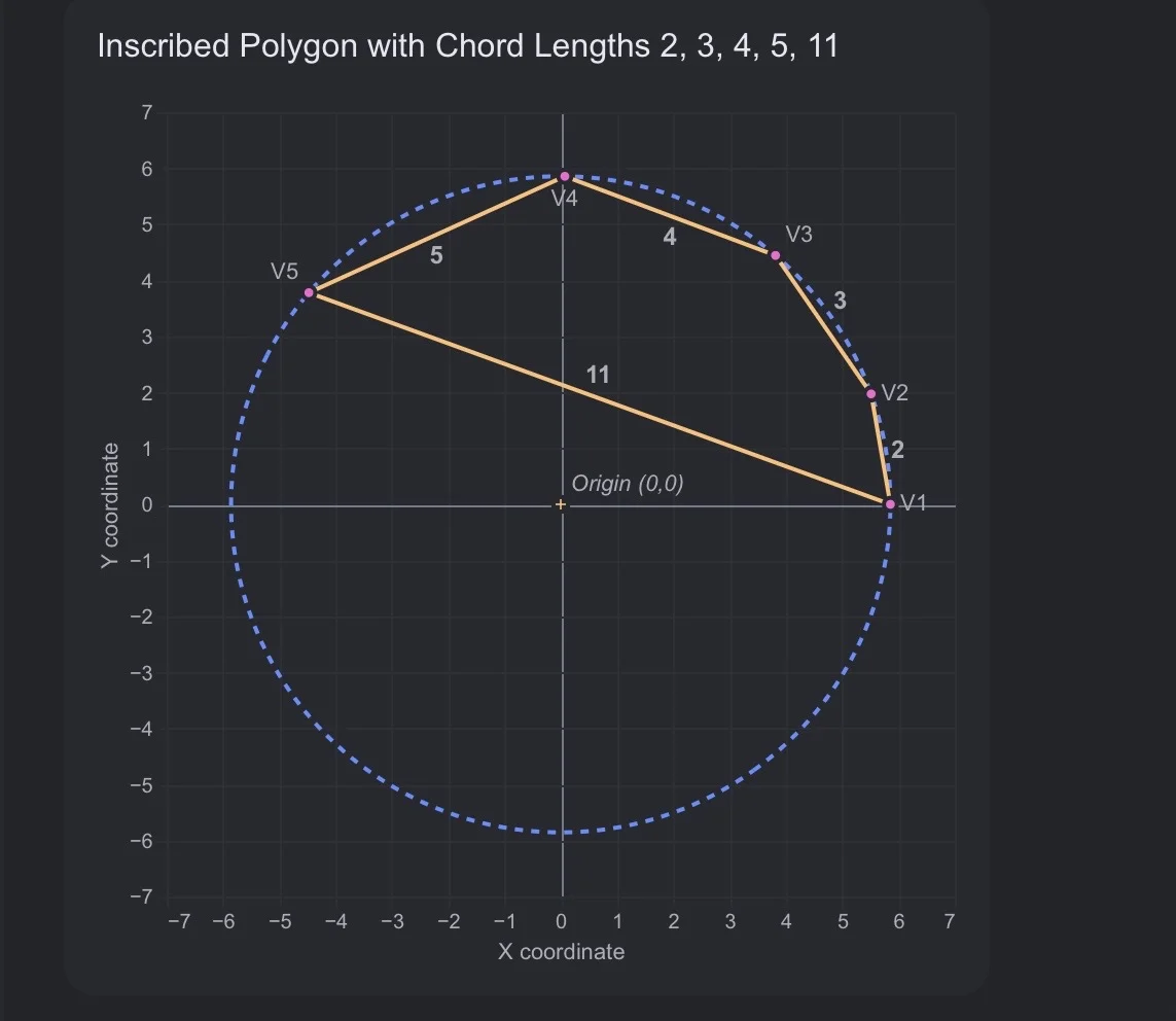

And here is a case for (2,3,4,5,11). In this case the sum angle is 1.063 rads which is less than ##\frac{\pi}{2}## so the circle center is outside the polygon.
Plot titled Inscribed Polygon with Chord Lengths 2, 3, 4, 5, 11: five vertices V1 to V5 on a dashed circle centred near the origin, joined by chords labelled 2, 3, 4, 5 and 11, with the 11 chord running from V5 to V1 and passing below the origin.
We use the equations from case 2 above to calculate the intersection.
