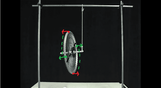

hello forum,
we all know that a rotation wheel, a rotating football, etc.. maintain their direction of motion with more stability than if they were not spinning...
A bicycle wheel is suspended from one of end of its axie by a rope, and spun up by hand. The wheel's axle is then placed horizontally and the free end of the axle processes about the supported end.
here the MIT video:
Why does that happen from a simple conceptual point of view? Why do the spinning parts of a spinning object give the object itself this stability?
I understand the formulas and the angular momentum explanation but I am wondering how we can explain this interesting phenomenon, this dynamical equilibrium, from the point of view of the rotating parts...

The behavior of gyroscopes is fairly easily explained in plain english. I'll use a screenshot from the video you posted for a quick illustration.
As you put force on the axel of the wheel, it will force the wheel in the directions indicated by the red arrows. Everything above the black dotted line will be forced in the direction of the top arrow, and everything below will be forced in the direction of the bottom arrow. As these red points rotate along the wheel to the green points, they're still being forced in the same direction, and by the time they cross the dotted line, they've got a small velocity in that direction. When these points keep rotating around beyond the green points, past the dotted line, they'll begin to be forced in the opposite direction, but this force is spent just counter-acting the small velocity in the opposite direction of the force, which came from being on the other side of the wheel. When the wheel is spinning very fast, it doesn't allow enough time on a single side of the wheel in order for a given point on the rim to build up significant velocity before it crosses over and gets canceled out.

me again:
so you are saying that the top red point is being pulled to the left side but in the meantime it is rotating to the green point where it starts being pulled in the opposite direction...
If the rotation speed is high enough, while the red point is still subject to the left force, it should move "a little bit to the left" and as it crosses the black line it should, in virtue of the force on the right to move to the right...but it does not...

Hello D H,
so, in the Gyroscope, how do you explain that while a point is moving and pulled by a force on the left it is not moving in that direction? After 180 degrees the force on that same point changes and becomes to the right...
Is the switching between the two forces so fast that there is no effect on the rotating point(s) at all?
It is torque, not force, that makes the gyro precess. Forces of course beget torques via [itex]\vec T = \vec r \times \vec F[/itex]. The torque is thus perpendicular to the force, so the precession is normal to the applied force.
I see the formula and that the torque is normal to the force...
but I wonder how each rotating portion of the wheel is not pulled, from a physical point of view more than mathematical, in the direction of the force...
Some explain it with inertia and the tendency of the parts to continue to move in their rotating motion...but that does not explain the absence of displacement along the direction of the force...
Trying to undertstand what happens to "each rotating portion" of the wheel is hard, because you need to take account of the forces acting on that part from the rest of the wheel (i.e. the stress distribution inside the wheel) as well as the applied forces. In other words, you can't think about one part on its own, you have to think about everything together.

AlephZero,
I agree with you: each portion is constrained...But do you personally have a conceptual explanation of why the wheel does not fall under the torque (only precesses)?
