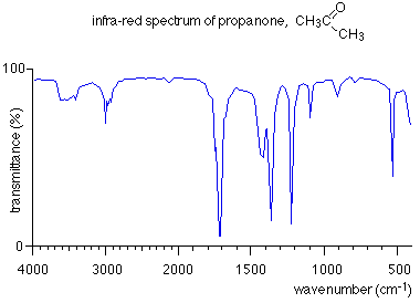

what did you mean by "narrow spectral 'slice'"? But if you will see IR graph like the following:
Infrared spectrum of propanone (acetone), with transmittance in percent on the vertical axis from 0 to 100 and wavenumber in cm-1 on the horizontal axis from 4000 down to 400. Deep absorption dips appear near 1700 and between 1200 and 1400 cm-1.
you will see that the IR spectrometer has spectral range of 500to 4000 cm-1 or about 2.5um to 20um which are even more than the spectral range of thermal imager which are usually about 7.5um to 13um. Maybe you meant something else by "narrow spectral 'slice"".. what is it? Thanks.

I mean each individual pixel of the detector records light within a very narrow spectral band. The detector (a 1-D array of pixels), 'slices' the broadband field into an array of narrowband fields.

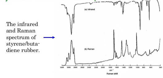

Thanks for that. I'm puzzled about something. IR spectroscopy and Raman spectroscopy are based on two distinct phenomena.. but how come the Raman scattering spectrum and infrared absorption spectrum for a given species often resemble one another quite closely in terms of observed frequencies? For example:
Stacked spectra of styrene/butadiene rubber: (a) infrared absorbance trace above and (b) Raman spectrum below, both plotted against wavenumber in cm-1 from about 3200 down to 400.
Raman scattering spectrum are supposed to be shifted in frequency due to the Stroke and Antistroke mechanism, and this having to do with polarization of molecules while IR spectroscopy is from the dipole moment.. these two are distinct so how much the frequencies (as detailed above) resemble so closely??
Although the mechanisms of interaction are different (and by the way, it's Stokes, not Stroke), the frequencies are determined by the molecular vibrational modes. Energy can only be absorbed by exciting one of these modes. So the spectra often look similar, especially for molecules of low symmetry like SBR. Differences arise because (i) the intensity of a particular mode in IR and Raman is often different, because the probability of excitation of that mode is a function of the mechanism of interaction; (ii) in molecules of higher symmetry, the symmetry selection rules are different for IR and Raman, so you can have modes that are active in one but not the other (or even in neither). In molecules with a centre of inversion, there are no modes that are active in both, as Raman only excites modes that are symmetric with respect to inversion, and IR only antisymmetric modes, so the IR and Raman spectra look very different.
