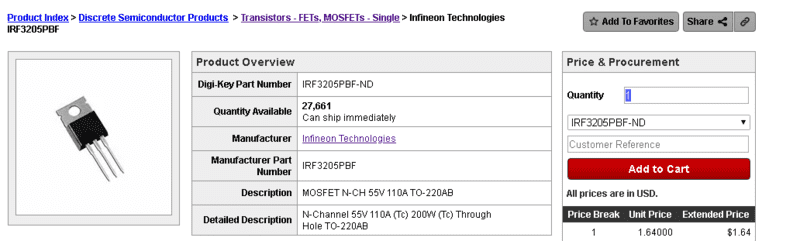

I need to replace a mosfet for a 3D printer. The seller and manufacturer were contacted on this but were not able to fulfill a replacement.
See this on mosfet:
IRF3205
P705D
KCAB
Here is photo:
https://plus.google.com/photos/photo/103754471497291178620/6538401194800693618
Unable to find exactly this one described above. Could any IRF 3205 work?
Your thoughts?
Yes. Those other numbers and letters are lot/date codes.

Thanks for the recommendations. Just ordered a set of replacements. Thanks everyone!
The way to start is with manufacturer's selector guide. Look for one with same voltage and current ratings.
from http://www.irf.com/product-info/fact_sheet/farnell/10527.pdf
have you tried searching for that part number ?
https://www.digikey.com/product-detail/en/infineon-technologies/IRF3205PBF/IRF3205PBF-ND/812033
