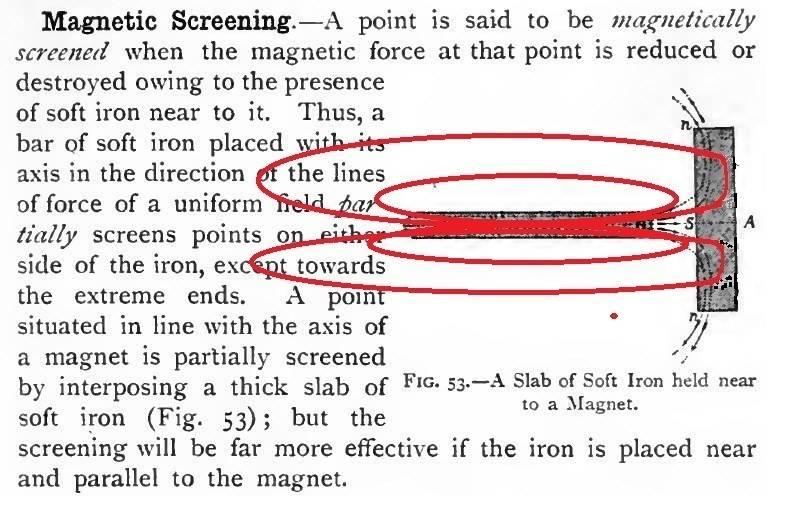

jim hardy said:
Maybe a picture will help.
First thing to straighten out is magnetic flux , like current, makes its way back to the source. Think "Closed Loops".So in OP's first picture
here's what i would add to hopefully resolve the misunderstanding.
Flux (in red) will prefer the permeable iron slab , not the impermeable air behind it. (well, permeability of just 0.00000126)
That image in MarcusL's post 14 is just great , shows how an iron pipe routes flux around its hollow middle. That's why we use iron conduit for some sensitive signal wires in the power plant.
Thanks for taking the time to draw the magnetic lines in red. But I go back to my initial point and say you don't have any experimental proof that the lines actually go so deep in the iron plate, I think they enter the plate (if at all) very superficially, most of the lines just glide past the surface (iron screens them), that's why the poles seen at the edges are towards the magnet side and not also to the rear side. Also I have a great deal of trouble understanding why a N pole is not induced at A on the plate since iron is such a "high permeability" material, which also tells me iron's screening is real and not due to "high permeability".
The iron pipe routing the flux around its hollow middle can be seen also as a proof that iron is not permeable to magnetism, thus prevents the magnetic field from passing through. If the pipe were made of plastic, that would be a "highly permeable" material to the magnetic field since it let's the magnetic field pass through.
