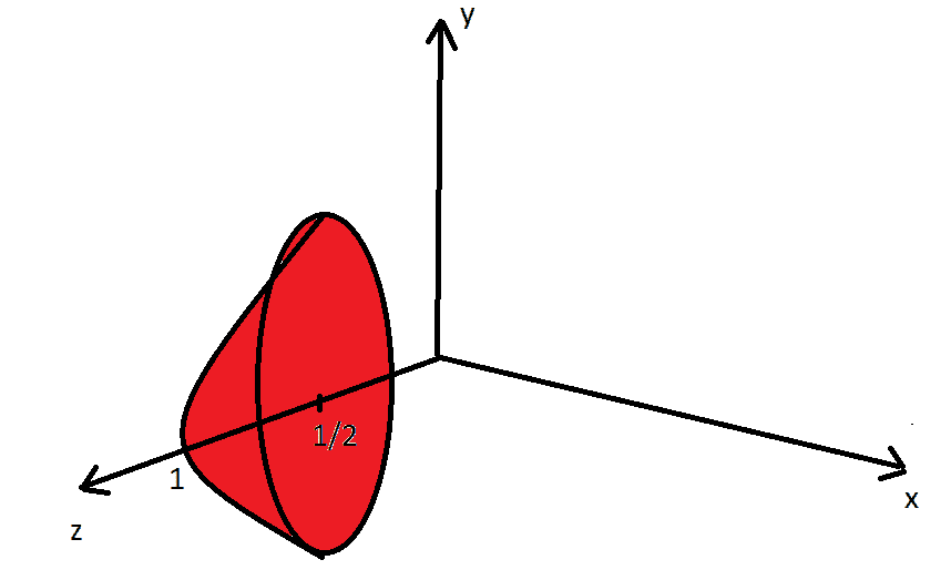

  2. $D_2=\left \{(x,y,z)\mid \frac{1}{2}\leq z\leq 1, \ x^2+y^2+z^2\leq 1\right \}$
    $x^2+y^2+z^2\leq 1$ is a sphere. From the inequality $\frac{1}{2}\leq z\leq 1$ we take only one part of the sphere, or not?

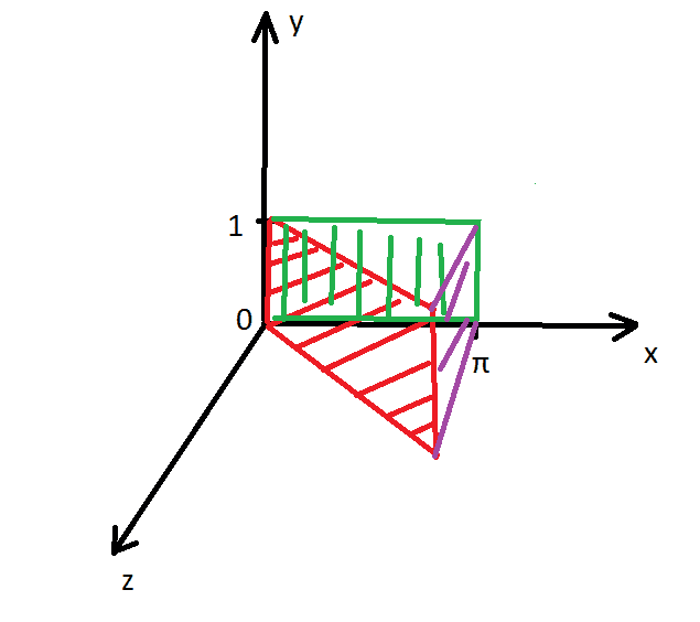

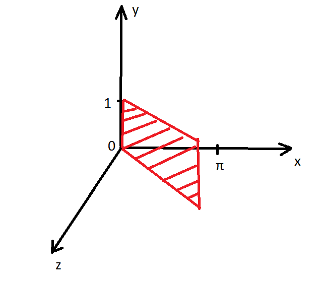

  3. $D_3=\{(x,y,z)\mid 0\leq x\leq \pi , \ 0\leq y \leq 1, \ 0\leq z\leq x\}$
    We draw the line $z=x$ on the $xz$-plane for $0\leq x\leq \pi$. Since $0\leq y\leq 1$, we get the following parallelogramm:
    Is this correct?
Yep. The top part where $z\ge \frac 12$. (Nod)
Is this correct?
Wouldn't $(\pi, 0, 0)$ be in $D_3$ as well? (Wondering)
So, will it be in the following form?
So, is $D_3$ the space between these three planes (red, green, purple) :
Erm... I don't recognize part of a sphere in there. :confused:
It should have a circle at $z=\frac 12$, and it should curve into the z-direction to the point (0,0,1), where it is closed.
mathmari said:
So, is $D_3$ the space between these three planes (red, green, purple)?
Yep. (Nod)
Ah, so should it be as follows?
That looks more like it. (Nod)
Although it looks more paraboloidical then spherical. (Nerd)

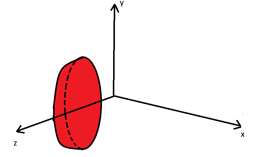

Oh yes (Blush)
It should be more like that
right? Do you have also an idea about the spaces $D_1$ and $D_4$ ?

mathmari said:
Oh yes (Blush)
right?
Yep.
