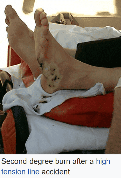

That person touched a wire with his hand.
  • Wow
  • Sad
Looks like he completed the circuit with his footwear, which presumably provided life-saving resistance.

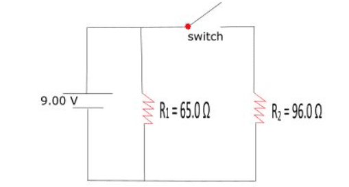

It's simpler than that. Think of this circuit (but neglect the numerical values).
R1 is the load resistance. R2 is the resistance of the person to ground, plus the reistance of ground back to the battery's grounded point. Current divides according to the standard formula for any two resistances in parallel.
Even though almost all current goes through R1, there could be an injurious or lethal current in R2. Wikipedia offers the following to help gauge severity. Note that both current and time are important. Note that both current and time are important, and that lethal effects can happen with just milliamps.

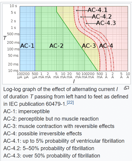

https://en.wikipedia.org/wiki/Electrical_injury
