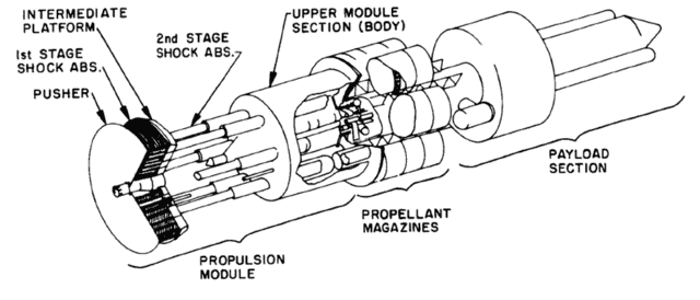

Project Orion, which aimed to use nuclear pulse propulsion, was canned for political reasons, but reached a demonstrator stage, of sorts, at least using conventional explosive pulses. Some clips from a recent BBC programme on it can be found here:
There seems to be no particular technical reason why this couldn't be built using H-bombs starting tomorrow, but whether anyone would let you build it, let alone launch it, is a whole different matter!
*I'll add that when I say 'demonstrated' I'm meaning no more that essential 'proof-of-principle'. Unless someone builds it, no-one will know if it is viable.
Here's a schematic of what was being aimed for, from the Orion project:

In any case, Project Orion is considerably different than the fusion-powered spacecraft hinted at by the OP. Orion would have been an incredibly inefficient means of propulsion. An efficient thrust system has a highly focused exhaust stream that is ideally at zero kelvin. The thrust from Orion would have been spread out over two pi steradians and the exhaust temperature would have been very hot temperature-wise. (That it would also have been "hot" in the radioactive sense was a political problem.)

I feel it is important to note that even disregarding the political factors involved in Project Orion there is no guarantee that the thing could or would work. I often get into discussions with people who pretty much assert that the only thing needed to finish Orion is building it but (correct me if I'm wrong D H) whilst a lot of theoretical work was done and some pictures were drawn there is no firm design.
Exactly. The only working prototypes were small dinky things that used convention explosives. Switching to different technologies and scaling up by many orders of magnitude is something that engineers at least have learned doesn't work on the first try. Or the second. Or the third. Or the ... And that's just the explosion and the pusher plate. I can imagine that the physical integrity of the pusher plate would be another problem. There would be one heck of a shock impulse going through the plate. I would think that that plate would have to be pretty much deformity-free.
Then there's the huge logistics problems: How to get all of that stuff to LEO. Ain't no way, no how that no country is going to allow an Orion-style rocket to launch from the ground. (Pardon the bad English. See [post=3650542]this post[/post].) The vehicle would have to be launched piecemeal by conventional rockets.
There would still be huge political problems. People protest launches of satellites that contain radioisotope thermoelectric generators. More recently, look right here at this site at the response to a barely measurable leak of radioactive iodine. One can only imagine the public's response to launching hundreds of full-fledged nukes.
