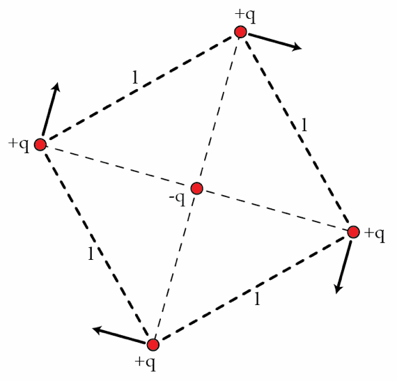

How did you get your equation for the force?
The motion in a 1/r^2-potential is called Kepler problem (he studied it for gravity), I guess you can use the formulas for that.It is amazing that such a system can exist (even if it is unstable).
My inclination is to solve the problem assuming L = constant = L0. The fact that the oscillations in L are not at all defined in terms of L(t) leads me to suspect that the net centripetal force on each +q charge is independent of L. That problem is pretty straight-forward.
However, I'm too lazy to prove that centripetal force is not a function of L.

What happens to the radial velocity at the instants of maximum and minimum elongation of the sides of the square?
It becomes zero.
dr/dt = 0 when the sides are Lo or 1/4 Lo. Lo is given in the problem. Use conservation or energy and angular momentum for these configurations.

I agree with your expression for the force.
where ##a=\frac{d^2r}{dt^2}##
In polar coordinates, the radial acceleration is not [itex]\ddot{r}[/itex] but rather ##\ddot{r}-r\dot{\theta}^2##.
The net force on a particle is an inverse square force. So, each particle travels an ellipse. I would follow mfb here. One of Kepler's laws should get you the answer straight away.
TSny mentioned Kepler's 3rd law, so you could roll with that and get the answer in a direct fashion analogous to the case for gravitational interactions. Since you already got the final angular velocity ##\omega_{f}##, you could also use ##r^{2}_{f}\omega_{f} = \frac{2\pi}{P}ab## where ##P## is the period and ##a,b## are the semimajor and semiminor axes of the elliptical orbit (which you are given in the problem statement) of anyone of the charges respectively if you want: http://en.wikipedia.org/wiki/Kepler's_laws_of_planetary_motion#Second_law

The semimajor axis is the arithmetic average of the min and max position and the semiminor is the geometric average. I think it would be much easier to just go with what TSny said and just use Kepler's 3rd law. It's (Kepler's 3rd law) is usually written down in terms of the gravitational attraction but the potential here is essentially the same, just with different constants, so you would just have to adjust that part.
EDIT: By the way, by arithmetic average I meant ##a = (r_f + r_i) /2## and by geometric average I meant ##b = (r_f r_i)^{1/2}##
What is ##r_f## then? Is it equal to ##a##?

No, those are not the lengths of the semi-major and semi-minor axes. They are the greatest and least distances to the central charge.
TSny said:
No, they are not the lengths of the semi-major and semi-minor axes. They are the greatest and least distances to the central charge.
I am still confused. Why the path of the charges is an ellipse? Shouldn't they travel in a circle with a changing radius? This is how I analysed the situation before posting the problem here.
What can be a circle with periodically changing radius? :)
A circle with a changing radius?
The motion of a particle acted on by an inverse square attractive force must be a conic section.
To put it another way, there is a maximum distance from the stationary charge that each of the orbiting charges reach and there is a minimum distance from the stationary charge that they reach. For the given potential, we can have an elliptic (which includes circular), parabolic, or hyperbolic trajectory. Here we have a periodic orbit with each charge having a maximum distance from the central chatge (apoapsis) and minimum distance from the central charge (periapsis) so we have an elliptical orbit.
From Kepler's third law
[tex]P^2 \propto a^3 \Rightarrow P^2=ka^3[/tex]
where ##a=(L_0/\sqrt{2}+L_0/(4\sqrt{2}))/2=5L_0/(8\sqrt{2})## and k is some constant.
How should I determine k here? :confused:
I discussed a similar question before where I had to find this k. Please look at this thread: https://www.physicsforums.com/showthread.php?t=700759 (post #5) Can I use the same way here?
Use the second law.
ehild said:
Use the second law.
##a=5L_0/(8\sqrt{2})##, ##b=L_0/(2\sqrt{2})##
##r_f=L_0/\sqrt{2}##, ##\omega_f=\sqrt{2\times 10^3 (3\sqrt{2}-4)}##
Plugging them in ##r^{2}_{f}\omega_{f} = \frac{2\pi}{P}ab##
[tex]\frac{L_0^2}{4}\sqrt{2\times 10^3 (3\sqrt{2}-4)}=\frac{2\pi}{P}\frac{5L_0^2}{32}[/tex]
Solving for P, ##P=0.178 sec##. Looks good?

No centrifugal force. How did you arrive at those numbers?
The area is correct. Show details of getting ωf. The formula for vpf in #11 was still correct.
