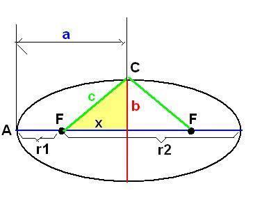

From Kepler's third law
[tex]P^2 \propto a^3 \Rightarrow P^2=ka^3[/tex]
where ##a=(L_0/\sqrt{2}+L_0/(4\sqrt{2}))/2=5L_0/(8\sqrt{2})## and k is some constant.
How should I determine k here? :confused:
I discussed a similar question before where I had to find this k. Please look at this thread: https://www.physicsforums.com/showthread.php?t=700759 (post #5) Can I use the same way here?
Yes. Compare Newton's law of gravity to the force expression you got for this problem to find the correspondence between GM in the gravity problem and the constants k, q, and m in this problem. See https://www.physicsforums.com/showthread.php?t=700759 (post #1)

I guess I made a mistake in my previous post. ##r_f=L_0/\sqrt{2}##, correct?
This time I get,
[tex]\frac{L_0^2}{2}\sqrt{2\times 10^3 (3\sqrt{2}-4)}=\frac{2\pi}{P}\frac{5L_0^2}{32}[/tex]
Solving for P, ##P=0.0891 sec##. Can you please check my post #28 and see if I used the right values for ##a## and ##b##?

I should have asked this earlier. Why a and b are the arithmetic and geometric means of the initial and final radii respectively?

Total energy is directly related to the semi-major axis. This follows from considering conservation of energy and angular momentum at apoapsis and periapsis, try figuring that out.
The semi-major axis and period are related via Kepler's third law.
