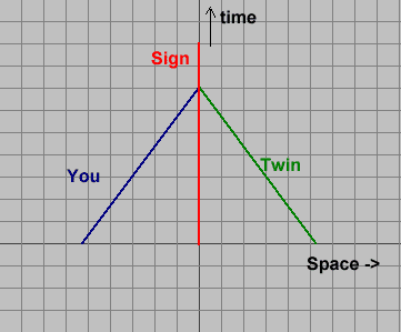

  • #61
To put it simply (I hope)
We measure 2Ls of distance.
1.333 secs later, we measure 0 distance.
How is that possible?
  • #62
James S Saint said:
No it is according to US.
Who is "US"? You? Your brother? The ground? All three frames will measure different distances and times.
You say "US", but you are actually using ground frame measurements.
We measure 2Ls of distance. In merely 1.333 secs, we measure NO distance between us. How is that not 1.5c?
It is 1.5c, but only in the ground frame. You used distances and times in the ground frame, so the closing speed is in the ground frame.

  • #64
Where's the problem?
You are confusing a closing speed greater than c with something actually moving with a speed greater than c in some reference frame. But that's not the case.

  • #67
jcsd said:
Is the light therefore traveling at greater than 1.5 times the speed of light? That would be totally illogical as we started by assuming it travels at the speed of light.
Also, what about someone standing at the one second mark and in the signpost's reference frame. If your brother shines a light back at that observer after he passes, will that observer see light traveling at 1/4 the speed of light? No.

  • #72
I'm still waiting on your explaiination of how fast light travels when it is coming from your brother's ship. I would love to hear how light travels faster than light.
