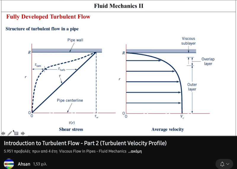

So i was watching a video about shear stress in turbulent flow and the narrator pointed out that the shear stress in turbulent flow consists of shear stress laminar plus shear stress turbulent. BUT as we go closer to the pipe walls the laminar shear stress dominates.
So i wanted to ask is the shear stress at the walls of the pipe basically the same for turbulent and laminar flow?

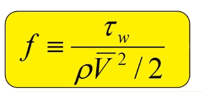

And when we defined the friction factor "f", was the shear stress(τ) in the nominator between the laminar layer and the pipe walls or was the shear stress between the laminar layer and the inner turbulent main layer?

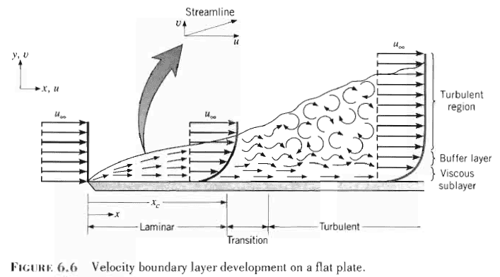

So, based on the previous discussion, let's replace this sentence with 'Closer to the pipe walls the viscosity dominates over the eddy viscosity', this is actually true, although 'closer' is not capturing what's really going on, see below.
Think now for a moment that turbulent flow just consists of eddies and simplify those as circular motions of fluid parcels. If you are in the middle of the pipe, the diameter of such a circular motion can be close to the pipe's diameter. But the closer you approach the wall, the smaller these circular motions need to be because there is a wall in the way. At some distance to the wall the motions become so small that they are damped again by viscosity. This is what happens in the viscous sublayer (not to be confused with a viscous boundary layer!). There, no eddies can exist and the flow is strictly laminar again.
To get a feel of the size of this viscous sublayer, consider a pipe of 2cm diameter (I guess about a typical pipe diameter going to your faucet) in which there is an average flow velocity of 2m/s. In this case the viscous sublayer is only about 25 microns (25e-6m) thick! So to say 'closer to the wall ...' doesn't really cut it...

And when we defined the friction factor "f", was the shear stress(τ) in the nominator between the laminar layer and the pipe walls or was the shear stress between the laminar layer and the inner turbulent main layer?View attachment 347050
As an aside: a fraction consists of a numerator and a denominator. A 'nominator' is not a thing ;).
The f (and thus also the ##\tau_w## ) is between the fluid and the pipe wall.

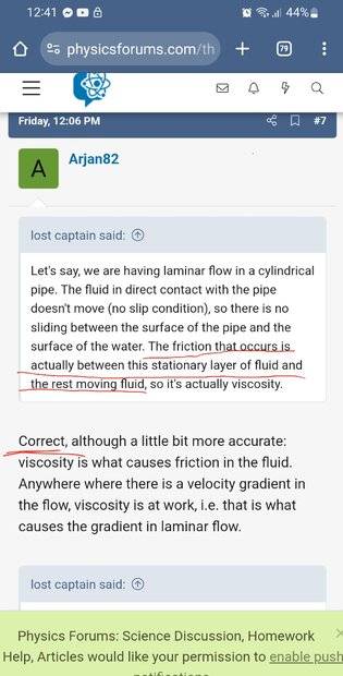

lost captain said:
But shear rate is equal to the velocity gradient... isn't it?
Not in general. The shear rate actually looks like this:
\dot{\gamma}_{ij} = \frac{\partial v_i}{\partial x_j} + \frac{\partial v_j}{\partial x_i}
In here you can substitute x-y-z for i and j, so ##\dot{\gamma}_{xy}## has i = x, and j = y. And it is the stress on a plane at a right angle with the x-direction directed along the y-axis (or the other way around..., this always messes me up...). For a flow in a pipe, there is only a ##dv/dr## term (##r## in radial direction) and there you can say that the gradient is equal to the shear stress (but there is a factor of two in there as well I believe... that's the other thing that always messes me up....)

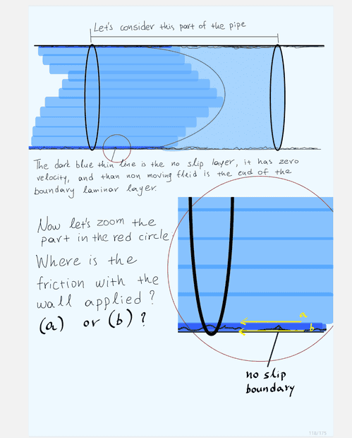

-Wall Shear stress in laminar flow: between a stationary wall and a moving fluid in laminar flow
-Wall Shear stress in turbulent flow: between
(a) between a stationary wall and a moving fluid, viscous sublayer, laminar flow
OR
(b)between two moving fluids a viscous sublayer, laminar flow and a turbulent layer
And both of these 2 wall shear stress are calculated using the same formula
So thats why i thought the (a) case was probably what was going on.
How exactly is this shear stress applied between the walls and the turbulent layer when there's a laminar layer between them?

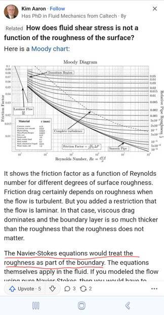

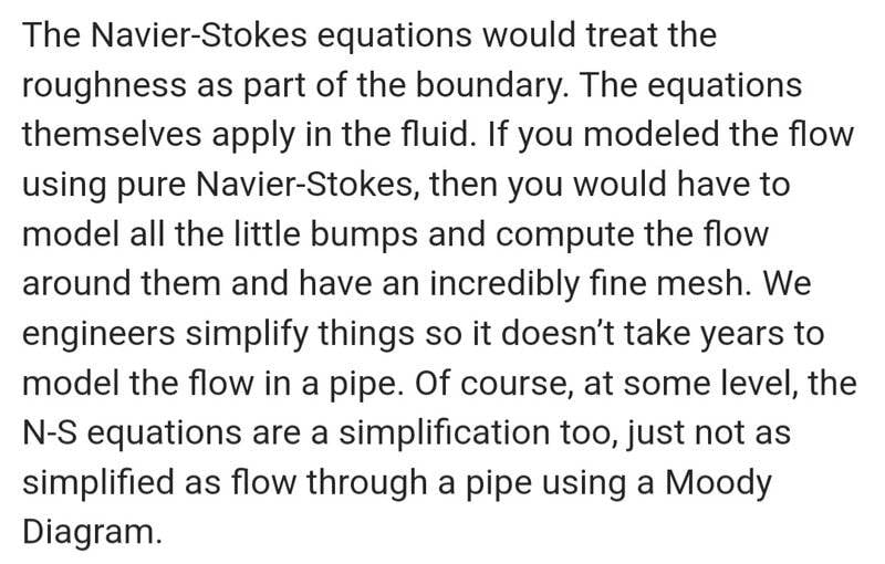

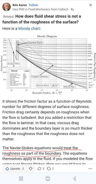

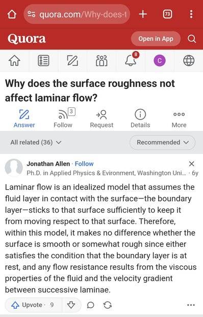

lost captain said:
The fact that there is a very thin viscous sublayer that's moving with laminar flow, is this actually true or is this some type of model to help us with the computations in turbulent flow?
No, it is really there in reality. It exists because very close to the wall turbulence cannot exist. The fluid has no room to fluctuate at some point close to the wall. But note that this layer is tiny! For a 2m/s flow of water through a 20mm diameter pipe this viscous sublayer is only about 0.025mm thick!

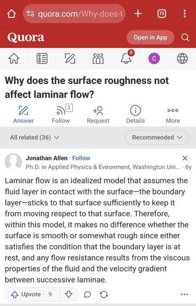

lost captain said:
If it is true or even if it's just the way we describe the turbulent flow at the walls of the pipe, doesn't this viscous sublayer with laminar flow, change the way we think about shear stress and friction?
No, why would it? Friction with the wall was, is and always will be equal to the viscosity times the shear rate at the wall. For both laminar and turbulent boundary layers.
lost captain said:
How is the shear stress between the turbulent fluid flow and the walls since between them exists this layer of laminar flow? And the same goes with friction.
Note first that what we call 'friction' is the shear stress at the boundary of the flow with the wall...
The name 'turbulent boundary layer' is for the whole thing, this includes the viscous sublayer, the buffer layer and the log layer. You seem to insist that the friction of a turbulent boundary layer needs to be between a turbulent part and the wall. But turbulence can simply not exist very close to the wall. However, the viscous sublayer is itself heavily influenced by the turbulence a bit further out (its gradient and its thickness). So the viscous sublayer is as much a part of the turbulent boundary layer as the log layer is.
lost captain said:
According to @Chestermiller the wall shear stress is always equal to the velocity gradient times the viscosity no matter the type of flow.
He said 'shear rate', not gradient. And I agree with him on that.
lost captain said:
This made me think that the shear stress is actually between the wall and the laminar sublayer.
The shear stress is defined everywhere, this means both everywhere inside of the flow as well as at its boundaries with the wall of the pipe. But if you are talking about the friction 'in a pipe', you mean the shear stress at the boundary between the fluid and the pipe. And it is indeed the viscous sublayer that is in contact with the wall.
lost captain said:
If that's not the case then the shear stress is between the viscous sublayer and the turbulent one, but again how come they both have the same formula?
Why would there be a different formula? Shear stress is only one thing, so you need only one formula.

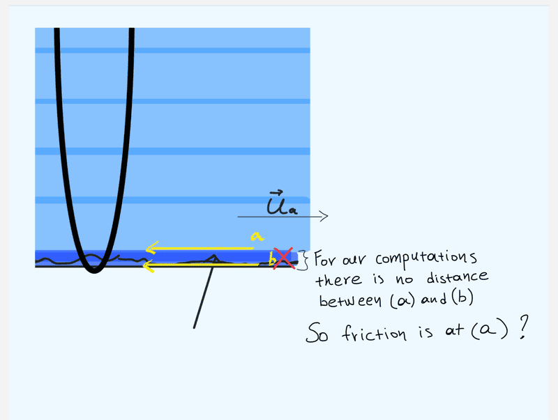

OR
It is (a) indeed.
There is no connection between the wall and the turbulent part of the turbulent boundary layer, so you cannot define a shear stress between them.

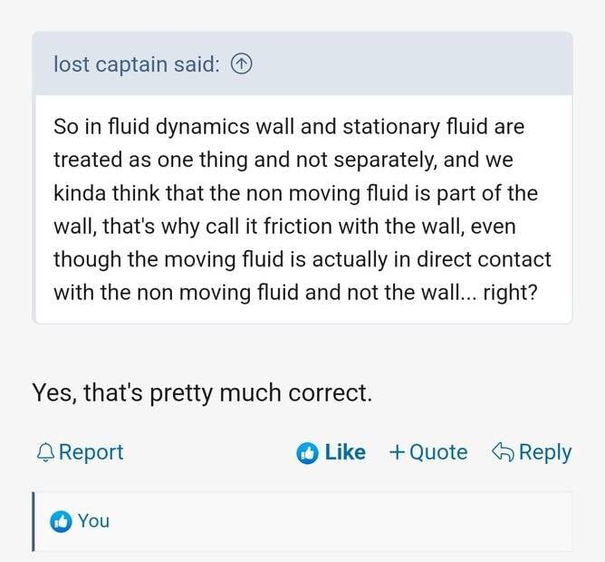

It's all clear to me now, THANK YOU
My confusion was coming from the fact that in laminar flow the thin layer that's not moving(no slip condition) on the walls of the pipe is being considered as part of the walls and not the flow. So i falsely assumed that the very very thin layer that's laminar flow, that is very close to the pipe, in turbulent flow is also considered as part of the pipe.
So just to be clear, when we talk about shear stress at the walls of a pipe in turbulent flow, that shear stress is applied at the viscous laminar sublayer. It's between the wall and the viscous sublayer.
And the same holds true for friction in the pipe walls, it is between the viscous laminar sublayer and the wall.
Of course this shear stress and the friction affect the whole flow, the whole turbulent boundary layer, but they do it through the viscous laminar layer.

🔸️This is because in fluid dynamics (and actually also in solid mechanics) you make the assumption of a continnuum for a fluid. This model makes this stagnant fluid layer infinitesimally thin. So you can not really identify it as a 'layer' and distinguish it from the rest.🔸
Because of the assumption of continuum we can't distinguish this very thin stagnant layer from the rest moving layer....okay.. but when we need to understand the friction and why it's independent of the pipe roughness in laminar flow, we need to distinguish them. When i am trying to think what is actually going on at the walls of the pipe, i need to make that distinction .
lost captain said:
Because of the assumption of continuum we can't distinguish this very thin stagnant layer from the rest moving layer....okey.. but when we need to understand the friction and why it's independent of the pipe roughness in laminar flow, we need to distinguish them. When i am trying to think what is actually going on at the walls of the pipe, i need to make that distinction .
Then I cannot help you

lost captain said:
I disagree with this. Laminar flow is not an idealization. Usually turbulent flow computations are an idealization, not laminar flow. If you have true laminar flow you can solve the Navier-Stokes equations exactly.
Also, I disagree with the statement 'Therefore, within this model, it makes no difference whether the surface is smooth or somewhat rough'. This is because also for cases where you do need to take roughness into account, you still apply the no-slip condition. This condition is not discriminatory for laminar flow, turbulent flow which is hydrodynamically smooth and turbulent flow with roughness. For all cases no-slip is applied (and actually present in real cases).
Lastly, he explains why a 'model' does not feel roughness, not why real laminar flow does not feel roughness...
For turbulent flow with roughness this is somewhat of an idealization. Because the surface with roughness is usually modeled as a smooth surface where extra turbulence is generated at the inner most layers (but still outside of the viscous sublayer) of the boundary layer.

Ok just to make one thing clear
(That no slip stagnat part of the fluid is the end of the laminar boundary layer)
I just want to know where is this pipe friction applied

lost captain said:
Ok just to make one thing clearView attachment 347081
In reality: neither, it is at the actual surface, so the rough line between (a) and (b).
In computations:
The part between (a) and (b) is not modeled in any usual fluid dynamical computation except the most highly advanced research based computations of people doing research on roughness itself. This is way to hard to do for any normal computation. So the distance between layer (a) and (b) is 0, the thickness of that layer is zero and thus (a) and (b) collapse.

How do you interpret the fact that laminar flow isn't affected by pipe roughness? Considering that the no slip boundary has no thickness, can it play any role preventing the pipe roughness to influence the laminar flow?
Do you agree with this approach?
It has to do with disturbance propagation (or hydrodynamic stability). In laminar flow a small disturbance is damped and dies out, and thus it influence is only very locally (i.e. directly around the roughness element). In turbulent flow a small disturbance becomes larger and larger, it grows way beyond the original disturbance and thus has a more global effect.
What does roughness do? It increases friction with the wall, how? By increasing the shear rate at the wall. How does it do that? By stronger mixing of momentum (axial velocity) towards the wall, i.e. higher velocities are transported closer to the wall and thus the gradient/shear rate increases. This turbulent mixing increases because the disturbances caused by the roughness elements spread, cause chaotic flow and thereby cause much more transport of momentum closer to the wall.
I don't know what you mean here. But for roughness to influence laminar flow it has to make the flow become hydrodynamically instable, this would then 'trip' the boundary layer towards turbulent flow. This indeed happens if the roughness elements get large enough.
lost captain said:
What you underline here is what would need to be done to compute the influence of roughness elements explicitly. This is very VERY expensive (computationally and money wise) to do so it is never done in normal engineering.
If by 'approach' you mean: use the Moody Diagram, yes, of course, by all means.
If by 'approach' you mean, model the full roughness explicitly, well, then you better be a billionaire...
In computations:
Is this correct? Also the layer (a) has velocity right?

Ok, I've tried... You clearly don't believe me. That's a 2sec demonstration with a bit of manual messing around with some die, if that convinces you more than the precision measurements and computations that are behind all the statements I made than I cannot help you...
About the second thing, I'm not going to repeat myself again.... We are going in circles over and over again.
I would recommend you to go to a university and read some good books about fluid dynamics and math.
