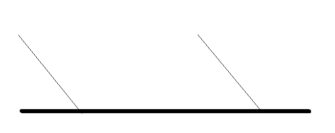

In addition, if one hangs a long, rigid, horizontal bob beneath two parallen pendulums then even though the oscillation is not in a straight line, it is pure "translation" because there is no "rotation".
