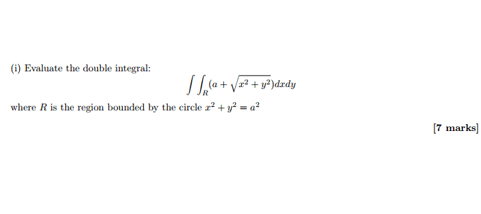

Printed exam question: (i) Evaluate the double integral of (a + sqrt(x^2 + y^2)) dx dy over region R, where R is bounded by the circle x^2 + y^2 = a^2. [7 marks]
As with my other recent posts, I just want to check if I'm right or wrong as I don't have an answer scheme to go by.
For this question I simply converted to polar to get:
∫∫(a+a)r drdθ
for 0<r<a, 0<θ<2π ,
which solved to give
2πa3 .
Was that correct? I'm convinced I did something wrong because it seems a very easy 7 marks.
Thanks!
You almost got it right. You made a silly arithmetical error. The integrand should be (a+r)r not (a+a)r.
##\int_0^a\int_0^{2\pi}(a+r)r d\theta dr##
Aaah right ok. Hmmm maybe a silly arithmetic error, but I can't see why it should be (a+ar)?
For converting to polar I did, dxdy = r drdθ,
which I presumed would then give the expression I used.
I can't see where I went wrong?
Sorry it should be this ##\int_0^a\int_0^{2\pi}(a+r)r d\theta dr##. What is ##\sqrt{x^2+y^2}## after you transform it into polar coordinates? What is ##x## and ##y## in terms of ##r## and ##\theta##?
Ah yeah I think I follow now. I think the x2 + y2 = a2 thing threw me a bit, making me think I should just swap it for an 'a' when really I can't do that at all.
It should be
f(x,y)dxdy → f(rcosθ,rsinθ)r drdθ
So in the case of the question
[a + √(x2 + y2)] dxdy → [(a + r)r] drdθ
