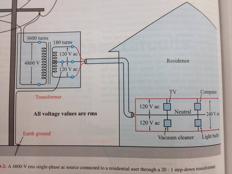

Also "to prevent "charging up of machinery" -- ugh, not it's primary focus ( but an important one) and the machinery is in the residence. This is discussing the ground of the step-down transformer. If it showed a ground rod for the residence, which there should be, that would be more applicable, but still not the primary purpose. The grounding of the transformer - and properly also at the residence - is to ensure there is no shock hazard when touching the electrical devices in the residence.
As drawn - if a device in the residence malfunctions - for example one of the 120V lines comes in contact with the device's surface, think outside of the washing machine - there is no solid connection shown between the device ( washer) and Ground - so depending on the essentially random arrangement of the whole system the surface of the washer is now at 120 - and the floor or water pipe that goes into the Earth is at the "ground potential" - a person could be shocked.
With out proper grounding system there is no guarantee that the surface of the devices are safe to touch.
Any book that talks of electrons 'going' anywhere in an AC circuit and uses the term "feedback path" is hardly an academic masterpiece. In that house wiring diagram, there is no mention of a safety Earth connection between appliances with a metal case and with pipework. Is that not a normal requirement in US installations?

The grounding stakes driven into the Earth are only for safety, they carry no load current. Should a hot wire short to ground then fault current is carried by the wire and through the earth. Grounding the power system keeps all wires in the grid at a known potential wrt earth.
Neutral wires in the 240 volt center tapped single phase household supply do carry current. The unbalance in current between the 2 outer legs of the 240 volts is carried by the neutral. In 3-phase ac power systems, the neutrals of Y-connected transformers, and the earth, and the overhead ground wires for lightning protection do not carry load current. They conduct current during a fault or lightning stroke.
Even if the 3-phase power is severely unbalanced, the system is designed so that the neutral carries virtually no current. Each transformer has 1 or more windings connected in delta which keeps the line & phase voltages well balanced even when the load currents are very unbalanced. A small fraction of the unbalanced current does conduct in the neutral, but a high impedance path (neutral conductors with their large inductive reactance over miles of wire) in parallel with a low impedance path (local leakage path in delta winding) still conducts a small fraction of the total current.
