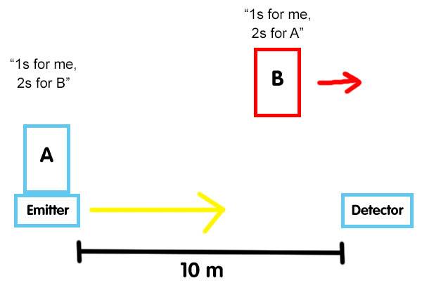

Wait, I think I see what you are saying. Knowing that time changes with speed doesn't tell you that there is an upper limit. It does tell you that moving faster than another object can cause you to perceive the passage of time differently than that object. No upper limit has to follow from this, but this difference in the passage of time is what allows there to be a limit which is also a constant to every observer, regardless of any relative motion. Does that make more sense?
Edit: Replacing the speed of light with an arbitrary number like 1,000 m/s really helped me understand the non-sequitur I was making. The limit can only be proven by observing the speed of something always traveling at the same rate relative to you, or by seeing how exactly time dilates (if that's the proper way of saying it) and deriving a formula to calculate apparent time passage differences between two objects at various relative velocities. Then, I imagine its just a matter of seeing at what point this formula would break down, and voila, limit found.

PeterDonis said:
One observer says it takes 1 second for the beam to travel from the source to the detector; the other observer says it takes 2 seconds, because of the difference in rate of time flow between the two.
If they are both moving only with respect to each other, then wouldn't the difference in the flow of the rate of time occur in each one, but only perceived by the other? I'm not seeing how you can say that one counts one second but the other counts two seconds when they are just moving apart from each other. How do you decide which object gets to experience more time than the other?
Using a light second seems like circular reason when you are measuring light speed. Measuring the distance something travels with a unit of measure based on how fast it should go, then deducing how fast its going from that. Or are you saying that when traveling quickly relative to another object, distance changes too?
Each one perceives his own time to flow at one second per second, so to speak; but that's not the same as saying that each one perceives the same physical process (in this case, the light traveling from a given source to a given detector) to occur in the same amount of time. See further comments below.
Because there are other objects in the scenario besides the two observers: there's a light source and a light detector. Suppose (which I should have said before) that the source and detector are at rest relative to each other. Then at most one of the two observers in relative motion can be at rest relative to the source and detector; suppose that the second observer, who sees the light taking two seconds to travel, is that observer. Then the other observer *must* be moving relative to the source and detector, and will therefore see the physical process of light traveling between them as proceeding more slowly; with the numbers I gave, he will see it as taking only one second instead of two, indicating a time dilation factor of 2, or a relative velocity of the source and detector with respect to him of 0.866c.
