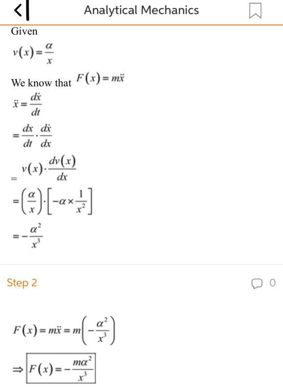

Anonymous_
TL;DR
I understand the formula f(x) =mx(dot) * x(double dot)
You basically just take the second derivative of the given function and multiply it by the original then multiple everything by m. I just don’t understand how the second derivative would be negative.

Are you asking why the derivative of ##1/x## w.r.t. ##x## is ##-1/x^2##?
You're given that v(x) = a/x, so v(x) is decreasing (assuming a > 0), which makes its derivative negative.
Anonymous_ said:
Got it
(1/x)=(x^-1)=(-x^-2)=(-1/x^2)
This makes no sense.
##\frac 1 x = x^{-1}##, but ##x^{-1} \ne -x^{-2}##
You apparently took the derivative to get from the 2nd expression to the 3rd, but you don't give any indication that that's what you did. If I were your instructor, I would mark your work down for this.

Not saying they are equal. The equal signs are steps => basically you have to multiple by negative one.

But you said they are equal:
I wouldn't have complained about this if you had showed what you are doing.
##\frac d {dx}(\frac 1 x) = \frac d {dx}(x^{-1}) = -x^{-2} = -\frac 1 {x^2}##

I wouldn't have complained about this if you had written "implies" => instead of "equals" =.
Or better yet, showed what you are doing.
I would just assume you would know what I mean since this is a physics site...
