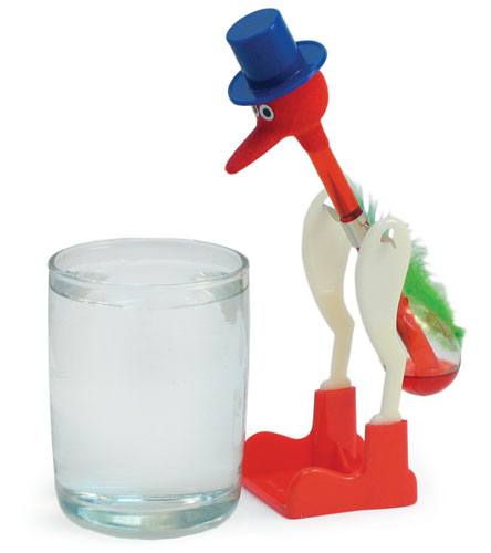

I'm looking to have some sort of material that I can make lighter/heavier on demand to create a weight imbalance in my device (it isn't very large-no more than a few centimeters).
Kind of like one of these sipping bird toys?
https://s3.amazonaws.com/cdn.teachersource.com/images/products/pop/db100.jpg
Or are you working on an Over-Unity Energy Generation Mechanism?
