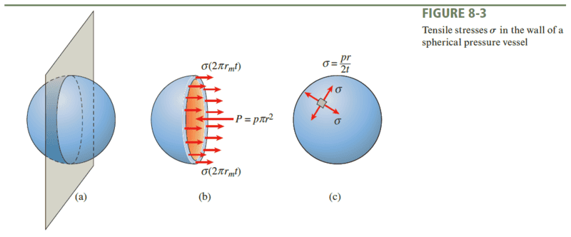

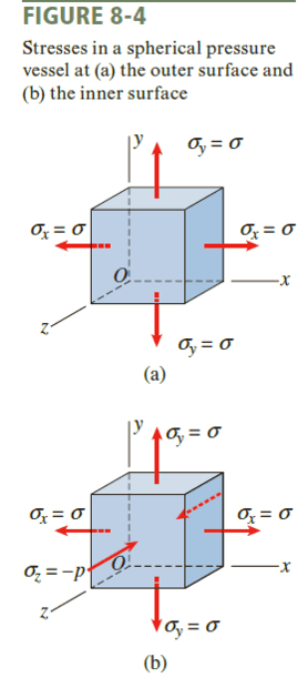

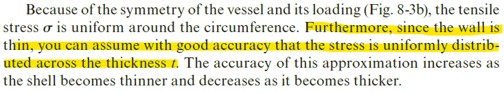

Question 1. Is it possible to obtain the stress distribution without assuming it's constant along its thickness?
Source: Mechanics of Materials by Barry J. Goodno and James M. Gere
The book is clear in the derivation with ##\sigma## uniformly distributed across ##t## but I'm wondering how to derive the formulas without using that assumption.

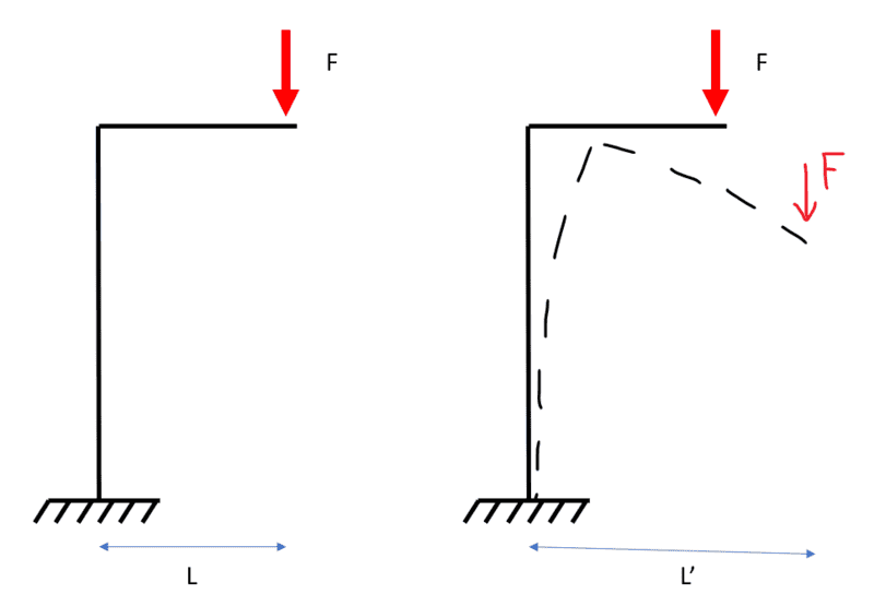

Question 2. If the displacements are large, what would the equations look like? What is typically taught in undergrad courses is related to small displacements (maybe with the exception of buckling in columns with Euler's formula). In such cases, the displacements/deformations do not affect the reactions or the stresses.
However, if in this case with the pressurized sphere, the displacements are large, as the inner surface increases the net force on said surface will become greater too because the inner pressure is held constant (there'd be a pump for example). So there is constructive feedback that will cause a deformation greater than the predicted by the "typical" formula. I tried deriving the formula for the large displacement scenario using the "normal" case as the base but I can't reach anything useful. Besides, in the large displacement scenario, I assume it's necessary to account for the change in thickness as the sphere expands but then I get even more complex formulas I can't solve in any meaningful way.

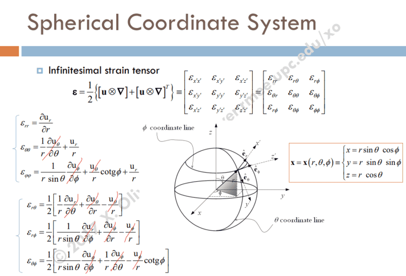

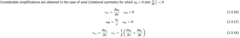

Do you mean this? (This is the source by the way)
Then, to find the principal strains ##\varepsilon_I##, ##\varepsilon_{II}## and ##\varepsilon_{III}## in terms of ##u## and ##r##, I would have to diagonalize the strain tensor. However, since there will be no displacement in ##z## either in this case, the tensor is already diagonal so ##\varepsilon_I=\frac{\partial u_r}{\partial r}##, ##\varepsilon_{II}=\frac{u_r}{r}##, and ##\varepsilon_{III}=0## where I assumed ##\frac{\partial u_r}{\partial r}>\frac{u_r}{r}## which seems extremely likely in a scenario as the one being discussed.
I’m asking for the strains in spherical coordinates, not cylindrical. The principal stresses and strains for this problem are in the three spherical coordinate directions.
Oh. My bad.
I actually started the problem with a cylindrical container but then moved on to a spherical one because it appeared earlier in the book than the cylindrical case. I guess it's ordered like that because the extra symmetry simplified a few equations. It's late and my brain played me there.
Anyway, the point is that's indeed the information you're looking for. Just applied to a different case.
I believe this should be the equivalent equations for spherical coordinates applied to the simplified case where the displacements only happen in the radial direction. (This is the source)
Again, the tensor is already diagonal so ##\varepsilon_I=\varepsilon_{rr}=\frac{\partial u_r}{\partial r}## and ##\varepsilon_{II}=\varepsilon_{III}=\varepsilon_{\theta \theta}=\varepsilon_{\varphi \varphi}=\frac{u_r}{r}##. That's also assuming ##\frac{\partial u_r}{\partial r}>\frac{u_r}{r}## as said in post #3.
Is that it?

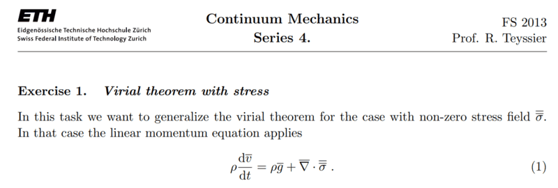

Juanda said:
Is this the origin of the stress equilibrium equation?
In this case, ignoring gravity so ##\overline{g}=0## and also with zero acceleration because it's in equilibrium so ##\frac{\mathrm{d} \overline{v}}{\mathrm{d} t}=0##.
Yes. The divergence of the stress tensor is equal to zero; this is the stress equilibrium equation.

That was a nice read. I had no idea about autofrettage. I knew about similar strategies used in reinforced concrete where the steel is in tension while the concrete is curing so that the concrete is pre-compressed to avoid tensional states. This being done in pressure vessels makes sense but I never knew it was an option.
Anyway, with some effort and thanks to the guidance from this thread I could follow the equations from the link you provided. After substituting, simplifying, solving, and simplifying again I now see what the tension in the body is:
$$\sigma_r=A-\frac{B}{r^3}$$
$$\sigma_{\theta}=\sigma_{\phi}=A+\frac{B}{2r^3}$$
After that, it makes sense to me why the book said "Furthermore since the wall is thin, you can assume with good accuracy that the stress is uniformly distributed across its thickness". If ##r_{max} \approx r_{min}## then the change in stress between the inner and outer shell will be very small too. It's kind of like how we consider gravity to be constant on the surface of Earth.

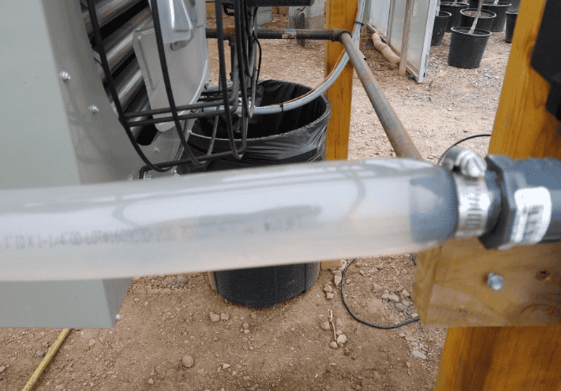

The original inspiration for the thread was this other post where flexible vinyl tubing is used in a water line (that's why I started thinking about the problem in terms of cylinders).
Let's then imagine that we're working with an ideal linearly elastic, isotropic material with low rigidity. Basically, I'm trying to understand how the equations would be if "The principle of relative stiffness" was not applied.

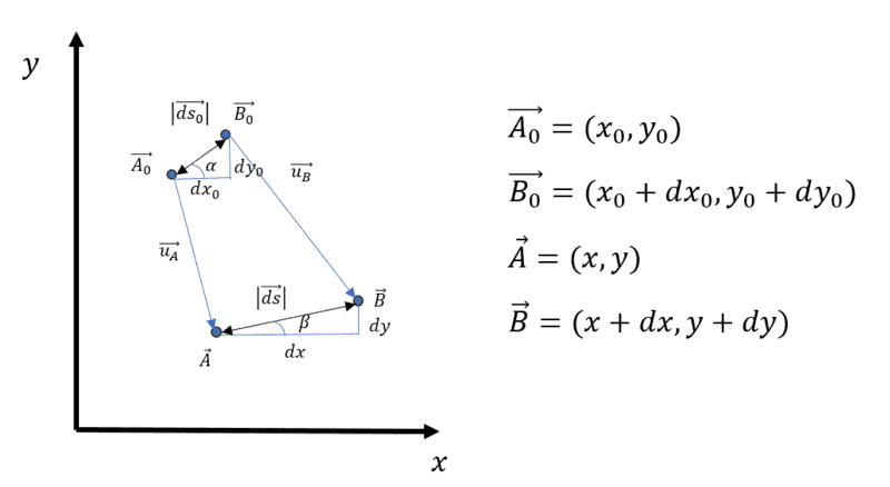

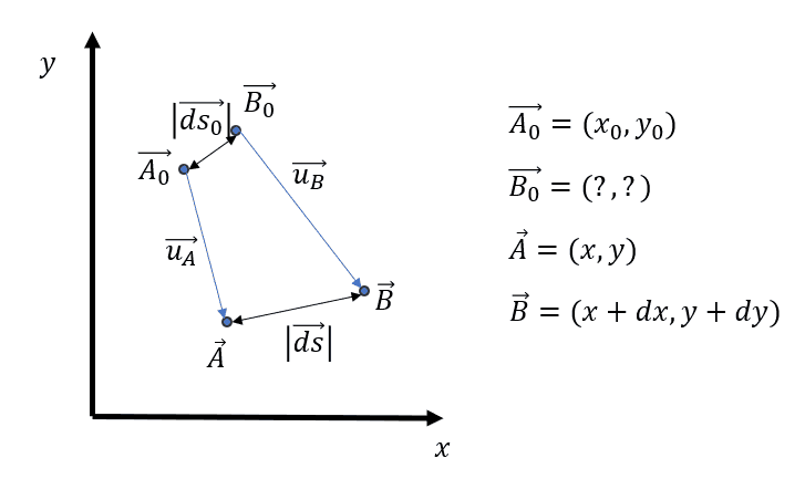

For a moment I thought I had it but no. I could make some progress setting up a differential equation to describe the problem but I'm missing information to solve it because I need more equations.
The orange area will grow as the body deforms. Its area will be:
$$S_r=\pi (r+dr)^2 = \pi (r^2+2rdr+dr^2) = \pi (r^2+2rdr)$$
The thickness of the circular crown in blue will change too.
$$S_R-S_r=\pi (R^2+2RdR-r^2-2rdr)$$
Then, the equilibrium of forces is:
$$(S_R-S_r)\sigma = S_rP_i \rightarrow (R^2+2RdR-r^2-2rdr)\sigma=(r^2-2rdr)P_i$$
Where I believe that ##\sigma## is ##\sigma = \sigma_{\theta}=\sigma_{\phi}##. I also think the additional equations I need must come from the deformation-displacement fields but I don't know how to set that up for this given problem because I don't believe I can simply use the same as before.
Finally, I don't know how I'd solve this differential equation either. Maybe later on it'll simplify and become more manageable but right now it seems too hard for me.

I suspect there exists a feedback loop with pressurized tanks when the inner pressure is kept constant (more deformation → more force on the sphere because of the increased surface and constant pressure → more deformation → etc.).
This is somewhat similar to a problem like the one shown in the following picture.
Typically, equilibrium and deformations are considered to be independent because displacements are considered small (principle of relative stiffness). Therefore, usually, we'd say the reaction at the base is simply ##FL##.
However, if we allow for the displacements to be large, the equilibrium after the deformation will be different and the reactions larger. In this example, if we take into account the displacement due to the external load, which would offer a more accurate solution, the moment at the base would be ##FL'## which is larger than ##FL##. Of course, if the displacements are small, both results are basically the same so there is not much added value to bother with the extra complexity because finding ##L'## is no easy task (that's the kind of thing I was trying to find out how to do with this post I mentioned earlier).

If the equilibrium of forces is not linked to the deformation, the book provides an easy derivation of the tension. (Note: I'll be using ##r## for the inner radius, ##R## for the outer radius and ##P_i## for the inner pressure.)
The force to the left done by the inner pressurized gas must be the same as the force to the right done by the tension in the shell. Again, since we're saying equilibrium is applied to the undeformed geometry, the equation looks like this.
$$P_i (\pi r^2)=\sigma (\pi(R^2-r^2)) \rightarrow \sigma = \frac{P_i (\pi r^2)}{\pi(R^2-r^2)}$$
From that, it's possible to obtain the stress in all directions which is enough to apply Von Misses and find out if it will resist or not.

Still, I think I can see the similarities in deformation when compared with expressions previously shared in the thread like:
$$\varepsilon_\theta=\frac{u_r}{r}$$
Which looks a lot like the expression of ##\lambda_\theta## you showed. I assume then that ##\lambda_\theta=\lambda_\phi## just like it happened with the tank before.
$$\lambda_r=1+\frac{du}{dr}$$
$$\lambda_{\theta}=\lambda_{\phi}=1+\frac{u}{r}$$

There are several different definitions of strain in the case of large deformations. They all reduce to the same equations for infinitesimal strains, but they are all different for larger strains.. So which one do you use? On the other hand, the stretch ratios are always the same. We are solving the balloon problem for large deformations. However, the relation between stress and stretch ratio is no longer known in advance using, say, the Hooke's law equations. In the balloon problem, all we know is that the stress is a non-linear function of the stretch ratio, which has to be measured in the laboratory in a separate experiment. One example of a finite strain definition (out of the many) is $$\epsilon=\frac{\lambda^2-1}{2}$$So, for our balloon case, we would have $$\epsilon_{\theta}=\frac{u}{r_0}-\frac{1}{2}\left(\frac{u}{r_0}\right)^2$$where ##u=r-r_0##.
To analyze large deformation behavior, a material coordinate system is always used. The material coordinate system acts as a permanent label for each particle of material comprising the body. Let ##x_0##, ##y_0##, and ##z_0## be the coordinates of a particle of material within the body in the undeformed configuration of the body. Let x, y, z be the coordinates of the same particle of material in the deformed configuration of the body. Then, the relationship between undeformed and deformed coordinates are defined by the mapping functions ##x=x(x_0,y_0,z_0)##, ##y=y(x_0,y_0,z_0)##, and ##z=z(x_0,y_0,z_0)##.
If ##z_0+dz_0##, ##y_0+dy_0##, ##z_0+dz_0## are the material coordinates of a closely neighboring material point in the undeformed configuration of the body, how are the differential changes in the coordinates dx, dy, and dz between the same pair of material points in the deformed configuration of the body related?
Wouldn't I need to know the functions for ##x##; ##y##; ##z## to be able to answer that question?
For example,
$$x=x_0+1$$
So every point moves 1 unit to the right. Now I can check where that neighboring point you described would end up by inputting that into the previous expression.
$$x=x_0+dx_0+1$$
Is that what you meant with your question?
