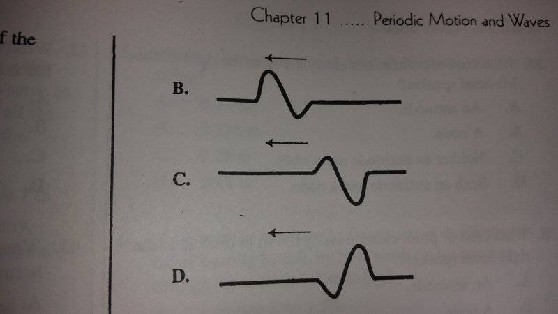

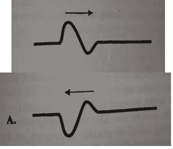

A wave is traveling to the right shown in the first picture. Which wave traveling to the left will momentarily cancel out the original wave moving to the right?
There are no equations, this problem is visual
It seems the answer C, in picture two, is the correct answer because the small dip in the original wave would first encounter the small upward bump coming from the right side. And then the large upward bump in the original wave coming from the left would then encounter the large dip and wait C cancelling them out. Wave A as the answer seems to have the original wave with a small dip encountering a large dip coming from the wave on the right first. This seems like it would not create a cancellation, but rather a larger dip combining the two dips together. I'm totally confused. The answer seems so straightforward that it would be answers C, but it is wrong
Cancelling the peaks is not enough. The waves must cancel everywhere. Compare the part of the waves between the small and large peaks. They are sloping in the same direction matching positive with positive above the baseline and negative with negative below the baseline. Can they cancel if that's the case?

The solution set says " The answer is A. The two waves, if superposed ,would add to zero at every point"
Perhaps the solution is wrong. That is a load off my mind to see that someone else agrees with me, because the confusion was maddening.
I could only see "A" as the answer, if the waves were moving in the same direction.
Also A and D cancel if they move in opposite directions. That's what I looked at earlier forgetting that A is not the given wave.
The answer is A because, as they pass each other, there will be a moment when the displacement of A is equal and opposite to that of the original wave at all points simultaneously, i.e. A will be the reflection of original in a horizontal plane. This is not true for C - the small peaks will cancel out as they meet, then the large peaks (not exactly as they are unsymmetrical), but not both simultaneously. The same is true of A and D.

kuruman, I think you were correct here. At some moment in time, the two waves must cancel everywhere. That means that one must be a reflection of the other in the horizontal axis. So A is the correct choice.
C is not the correct choice. It would cancel each point in the wave at some time, but not all points simultaneously.

Right. But they DO NOT start out superposed. That's why there are directional arrows. The first thing that would meet would be the small dip in the given wave and athe Large dip in wave A which would create a third even larger dip. If it doesn't matter in which order ih the elements of the two different waves meet, then I don't know what the point is of the directional arrows.
Ah, yes of course. The cancellation is expected to be momentary according to the question. I was trying to get the waveform to cancel at all times while the waves overlap.
