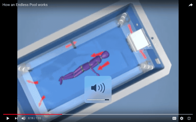

Hello, is this stupid?
is this project possible, about 1,500 usd.
I know the key is evenly distributed flow, so maybe two small motors. Maybe add a grate?
this vid gave me this idea:
thanks in advanced if anyone reads this thread

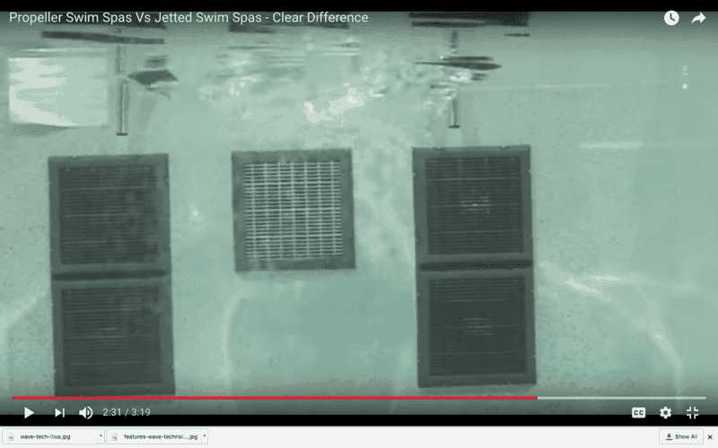

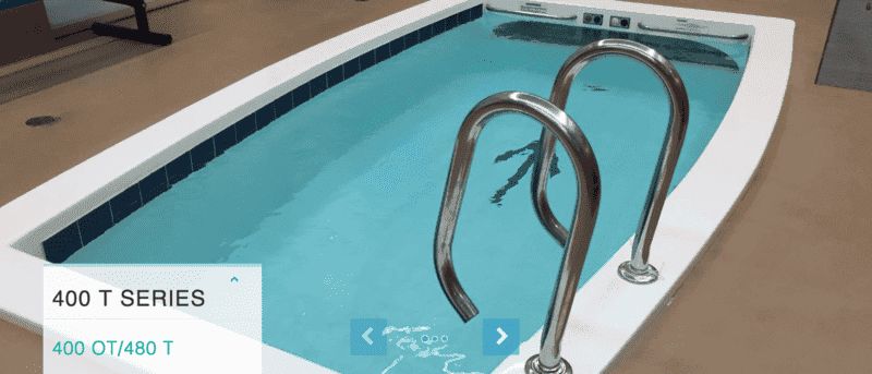

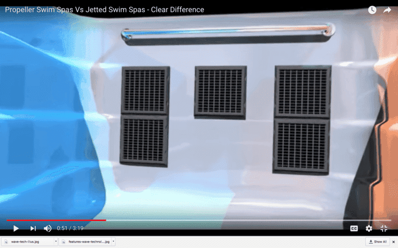

heres some screen shots of a few different systems

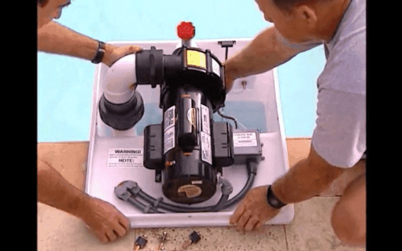

Here's a 4 horsepower pump, not the greatest reviews, I've heard reviews saying they need up to 2 x 4 horsepower engines for an average swim speed. cons: consumes power and feels like getting hosed

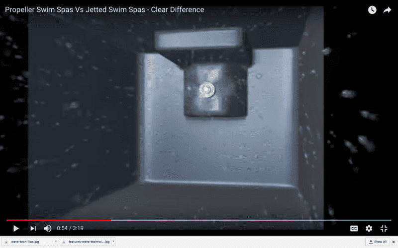

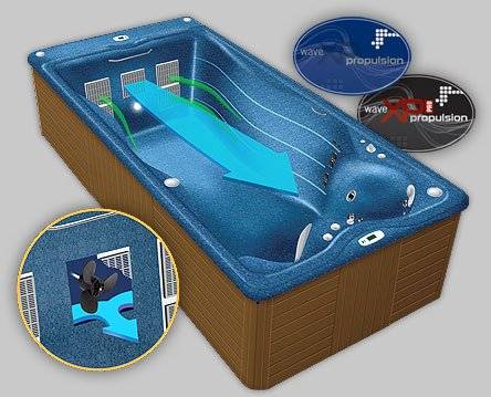

Swim Spa; in their introduction vid they said they used a custom propeller, I'm not sure how many props they have, but i think it's one.

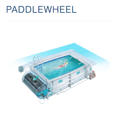

SwimEx seems like the ultimate Flume machine and is powered by a water wheel (excuse the pic quality, hard to find pics)
