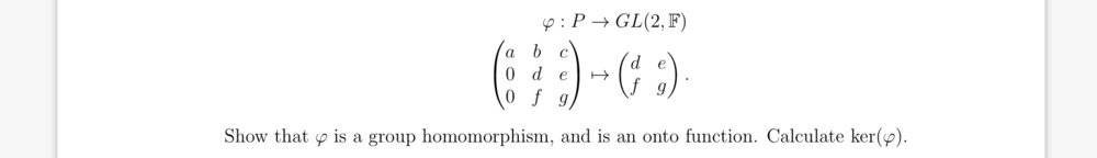

I’ve managed to complete it. Would you mind just telling me where I should start for the next part(I don’t have any notes regarding this)

Lauren1234 said:
I’ve managed to complete it. Would you mind just telling me where I should start for the next part(I don’t have any notes regarding this)View attachment 255818
You must show an attempt. Definitely since this is homework! I can provide you the definitions though.
To show it is a group morphism, you must show that for all ##A,B \in P## we have
$$\varphi(AB) = \varphi(A) \varphi(B)$$
By definition ##\ker \varphi= \{A \in P: \varphi(A) = I_2 \}## and you are asked to give a nicer description of this set.
Checking that ##\varphi## is onto should be trivial.
