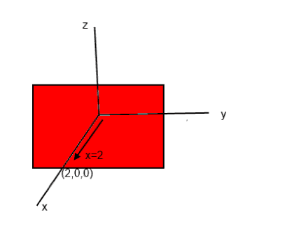

Hi,
I was trying to draw a plan 2,0,0 in X,Y,Z co-ordinate system
Is it correctly drawn ?
I think ...I'm wrong in drawing this plane
I think I'm wrong because each point in this plane has non zero y & z value...they are not having y=0& z=0 everywhere all the time although x=2 everywhere on this plane...so my drawing to plane (2,0,0) is wrong.
Could you please correct my analysis ?
If I'm wrong then what is correct way to draw the plane (2,0,0) ?

(2,0,0) is a point on 3D space.You draw x=2 plane
Hi, you must specify better your plane because there are infinity planes by a point ##(2,0,0)##. Do you want the plane passed by ##(2,0,0)## and parallel to the plane ##yz##?

I'm trying to draw a crystal structure plane (200)
I'm not sure ..how to draw that
I did wonder if that was it.
(2,0,0) is not a single plane; rather it's an infinite set of parallel planes. The planes ##(n_x,n_y,n_z)## are the set of planes whose ith member crosses the x-axis at ##i/n_x##, working in units where the unit cell's edges are of length 1. Similarly for y and z.

what do you mean by this ? can you show me how they look like ?
I just want to visualize it.

very much confusing...would it be possible to post an example with related to this ?

Pick an ##i##, say ##i=1##. What are ##n_x##, ##n_y## and ##n_z## in your case? Therefore, where does the ##i##th plane cross each of the axes? What does "at infinity" mean in practice?

i=1 i.e 1st plane
Ibix said:
What are nxnxn_x, nynyn_y and nznzn_z in your case
its 2,0,0
Ibix said:
Therefore, where does the iiith plane cross each of the axes?
1/2 , 1/0 , 1/0
.5 , infinite , infinite
so I conclude its one plane which passes through at x=.5 and crosses y & z at infinite i.e parallel to YZ
But you said
I'm getting confused more.
Yes - you've worked out one of the planes correctly. Now repeat for all ##i=\ldots, -2, -1, 0 , 1, 2,\ldots## and you have the complete set of planes. Of course, since this is crystallography and everything repeats periodically you'd only be interested in the ##i## that gives a plane that passes through the unit cell. Outside that you are just repeating yourself.

okay ...that looks fine.

all this happening in a specific unit cell ? i.e are we considering in this example i=...-2, -1, 0 , 1, 2... for a given unit cell ? is it correct ?
In your example there are only two planes in the unit cell, corresponding to ##i=0,1##. The ##i=2## plane is in the same place in the next unit cell along as the ##i=0## plane is in this one. I don't think there's any kind of theorem here. It's just a shorthand notation for a set of planes that uses the natural periodicity of a crystal to save on the writing. Usually the interest is that the crystal can be cut along planes (cleavage planes) and you can just say "this crystal cleaves along the (1,1,1) plane", or whatever.

I don't understand how do you arrive at this part
Ibix said:
whose ith member crosses the x-axis at i/nxi/nxi/n_x
that division ...thats not clear.
It's just what crystallographers mean by the (2,0,0) plane. They mean the set of planes parallel to the y-z plane spaced by half the llength of the x side of the unit cell. It's just a convenient notation for a concept that is useful in crystallography. It isn't something you can derive from anywhere - it's just something you need to learn.
