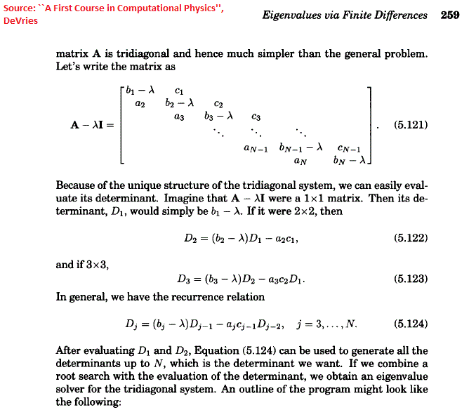

My own code. I don't want to bother you with code, but the essence of what is happening is pretty simple.
If you like, you can take a look at the page I attached. I'm basically using that iterative formula to calculate the determinant of a tridiagonal matrix. In my case, the elements a,b,c are pretty big (and if it matters: the eventual eigenvalues, at least the smallest ones, are "normal-sized", i.e. order 1). If I simply evaluate that determinant, as it is, I get wrong/NaN results, but if I first replace a,b,c by [itex]\alpha a, \alpha b, \alpha c[/itex] (with alpha small), and then solve for lambda, in the end dividing lambda by alpha, I get good results.
Maybe the specific formula (i.e. the one on the attached page) induces catastrophic cancellations? However, if that is the case, then I'm not sure why I have no troubles at all after rescaling, since then my lambda is typically really small, so relative to lambda, a and b are still huge, such that operations like in (5.122) should behave funnily(?)

OK. If you are trying to find the eigenvalues by determinant search, you don't really need the value of the determinant, only its sign. But the determinant is likely to be of the order of the product of all the diagonal terms of the matrix, so you need to keep track of a scale factor so that stays within the range of your floating point arithemetic. You could either scale the matrix, or represent the D's by an integer power of 2 (or 10 of you prefer) times a floating ponit number fairly close to 1. That would not overflow until the determinant was of the order of about 10^8 decimal digits, which should be big enough for most situations!)
Alternatively, you could do an LU factorization of matrix 5.121, which is about the same amount of work as finding the determinant but willl not overflow, count the number of sign changes along the diagonal terms of U, and use that as a Sturm sequence to tell you the number of negative eigenvalues for a given value of ##\lambda##..
Just the add: this is nothing to do with numerical conditioning, it is just the fact that the determinant is too big to represent as a floating point number. You would get the same problem running the code even if the matrix was diagonal and there was no cancelation at all.
For a large matrix, the matrix elements don't even have to be "big". For example if the elements of a matrix of order 500 were about 10, the determinant would be usually be about ##10^{500}##, but IEEE 64-bit floating point can only represent numbers up to about ##10^{300}##. But calculating all the eigenpairs of an arbitrary matrix of order 500 is not usually a big deal numerically in 64-bit arithmetic
FWIW the old LINPACK numerical library included determinant calculation routines, and returned the value as a power of 10 times a number between 1 and 10. The newer LAPACK libraries don't contain any determinant calculation routines at all, though you can get the determinant easily after calling other routines in the lilbrary if you really really want it.
