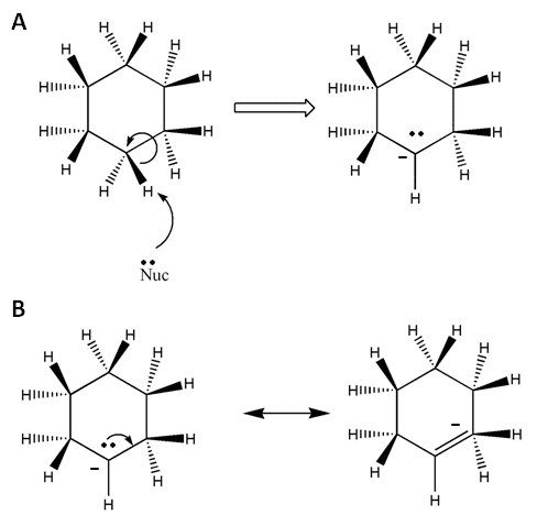

is mine just not valid because it violates the octet rule since there are H's involved as well?

I know it doesn't show all the places, I'm asking if that is ONE of them. I don't think it is, since wouldn't that mean the carbon would have 5 bonds? (another carbon, the double and 2 hydrogens) ?

This is correct. When learning to draw resonance structures, it is sometimes helpful to explicitly draw all of the hydrogens in order to prevent mistakes like this.
Physically, a resonance structure like this does not make sense because resonance is interpreted as the sharing of electrons among unhybridized p-orbitals. In the cyclohexyl carbanion you drew, only one carbon atom could potentially have an unhybridized p-orbital (the carbon with the lone pair). However, none of the neighboring atoms have p-orbitals capable of overlapping with the lone pair on the carbanion, so resonance is not possible.

So why is the 2nd step of my resonance structure invalid, then?
Perhaps pictures would help here (see attachment).
Figure A shows the formation of the cyclohexyl anion. As I mentioned on my first post, a very strong nucleophile would remove the hydrogen from cyclohexene. The two electrons in the C-H bond that is broken are left on the carbon atom as a lone pair.
Figure B shows the resonance structure that you proposed (with hydrogen atoms and lone pairs explicitly shown). As mentioned previously, the resonance structure involves a carbon atom with five chemical bonds, a situation which is impossible.

So my 2nd structure isn't valid because that would mean the carbon would have 5 bonds? (another carbon, the double and 2 hydrogens) ? If that's right it seems the hydrogen is still there?
Again, refer to the diagrams in my previous post. To form the anion, you remove a hydogen from the bottom-most carbon (if you imagine that the cyclohexane ring is a clock, this is the 6-o-clock carbon). As you can see the 6-o-clock hydrogen has only one hydrogen, while the other carbons have two.
In the resonance structure, the 6-o-clock carbon is fine. It has a single bond to the 7-o-clock carbon, a single bond to a hydrogen, and a double bond to the 5-o-clock carbon. Since this carbon has four bonds and no lone pairs (giving a total of eight electrons), there is no problem.
However, there is a problem with the 5-o-clock carbon. This carbon has a single bond to the 2-o-clock carbon, two single bonds to hydrogens, and a double bond with the 6-o-clock carbon. This is a total of five bonds, totaling ten electrons and violating the octet rule.
