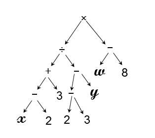

Hello I just wanted to see if I did this right. I've come up with two trees and I'm pretty sure one of them is correct, I'm just not sure.
Construct the Tree of the algebraic expression:
((x - 2) + 3) / ((2 - (3 + y)) x (w - 8))

Hi! :) I think that both of them are right,but it would be better to include also the parentheses of the algebraic expression at the trees,that you constructed.
Okay thank you. I also had to do this with one of the trees. So I picked the first tree. Does this look correct?
1) Show the results of performing a preorder search.
× ÷ + - X 2 3 - - 2 3 Y - W 82) Show the results of performing an inorder search.
X – 2 + 3 ÷ 2 – 3 – Y × W - 8 3) Show the results of performing a postorder search.
X 2 - 3 + 2 3 - y - ÷ W 8 - ×

I also tried it,and found the same result as yours!It should be right! (Nod) (Yes)
The one on the right is correct, the one on the left is incorrect. The one on the left is evaluating the expression $\dfrac{(x-2)+3}{(2-3)-y}(w-8),$ whereas the one on the right is evaluating the expression $\dfrac{(x+2)-3}{(2-(3+y)) \cdot (w-8)}$. You can see that in the left version, $w-8$ is in the numerator, whereas in the right version, $w-8$ is in the denominator.
So the one I did starting with Division is actually correct
Oh,yes you are right! Sorry for assuming that the left tree is also right.. (Sadface)
Right - the "biggest" mathematical operator is the last one you'd evaluate.

So then would this be correct for the tree on the right?
÷ + - X 2 3 × - 2 + 3 Y- W 82) Show the results of performing an inorder search.
X – 2 + 3 ÷ 2 – 3 +Y × W - 8 3) Show the results of performing a postorder search.
X 2 - 3 + 2 3 y +- W 8 - ×÷
Yes, they seem correct.
