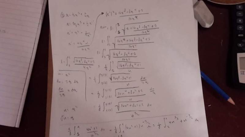

X= (1/3) y^3 +1/4y. Find arc length between 1 and 3.
X prime squared= (4y^4-1)/4y^2
Now plug into arc length formula.
L=sqrt of (1+x prime squared)
Now L= sqrt of
I uploaded a pic to make it easy. My sub is on the middle of the left page

The U=y^2 came from the denominator. When I take the u sub of something in the denominator can I write it as a linear function. Or must I always make it a rational function.
If u = 4x^2, then du = ?
I factored the 1/4 out and put it outside the integral sign. So now my denominator is x^2. N du/2x= X was this step wrong? My question still isn't being answered. I'm not asking for help getting a solution but rather regarding how u substitution works when substituting something in the denominator for u.
I attached an image to show my work. Can somebody comment on out? Thanks

That attachment is a bit hard to follow. In the Original Post, you have the numerator being: [itex]\ \sqrt{16x^8+8x^4+1\,}\ .[/itex]
Then in your attachment the same expression appears with y rather than x, except for a change of sign on the 4th degree term. After that, you sub. u for y2 and get [itex]\displaystyle \sqrt{16u^4+8u^2+1\,}\,,\[/itex] this time with the + sign returning. At any rate, at this point you see that [itex]\displaystyle\ \ 16u^4+8u^2+1\[/itex] factors to [itex]\displaystyle \ \ (4u^2+1)^2\ .[/itex](Corrected) This allows the radical to be removed altogether. Do a similar thing -- factor -- the original integrand. It will make life much easier.
Added in Edit: It was too late last night when I posted this !
As benorin points out below: That should be [itex]\displaystyle \ \ (4u^2+1)^2\,,\[/itex] rather than [itex]\displaystyle \ \ (4u^2+4u+1)^2\ .\[/itex] (Corrected in the above.)
Of course, benorin was working with [itex]\displaystyle \ \ 16x^8+8x^4+1\[/itex] and not [itex]\displaystyle \ \ 16u^4+8u^2+1\ .\[/itex]
