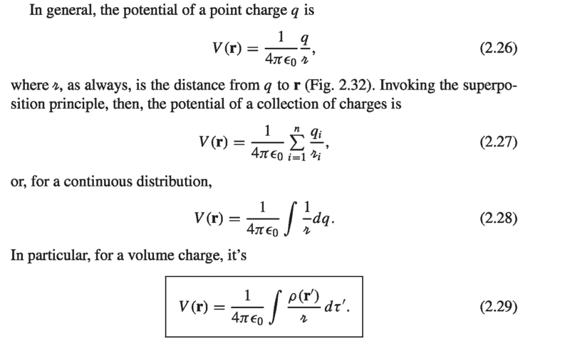

I consider ## \lambda ## as an electrostatic potential. Now, if ## \nabla ^2 \lambda = 0## is valid for all space →then there is no charge in the whole space i.e charge density is 0 in the whole space, then electric field i.e. ## -\nabla \lambda ## in the whole space has to be zero. Isn't this argument correct?

Sorry for being not clear. I took ## \lambda## as electric potential analogically.
But, if there is no source for ## \lambda ## in all space, how can there be non-zero ##\nabla \lambda##?
Consider the following eqn.:
##\nabla^2 v =0## ,if there is no source in all space i.e. charge density is 0 everywhere, then ##- \nabla V ## has to be 0.
In a similar way, ##\nabla^2 \lambda =0## ,if there is no source for ## \lambda ## in all space, ##\nabla \lambda = 0##.

In the analogy to an electric potential, it would be a potential that changes linearly in some direction. ##\lambda = \vec r \vec d ##with an arbitrary vector d.
I can't understand that if there is no charge in the whole universe, how there can be a changing potential. Potential difference is due to the presence of charge, right?
But your argument says that even if there exist no charge, there exist potential difference?
I guess now I understood, in case of potential difference, it is assumed that potential difference at infinity is 0( which is the general case). Under this assumption, ##\nabla ^2 \lambda = 0 ## gives ## \nabla \lambda = 0##.
Here, in case of magneto-statics, I can take ##\lambda ## such that ## \nabla \lambda ## is not 0 at infinity, so ## \vec A ## is not unique .
